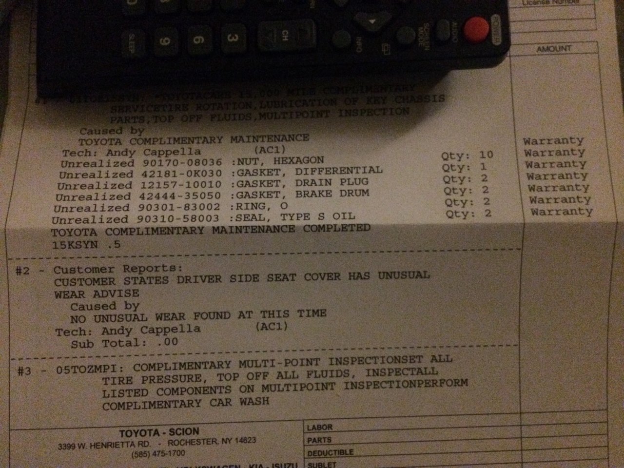

    Went in yesterday for my 15k toyota care. They are going to replace my rear diff Monday morning at 8am....

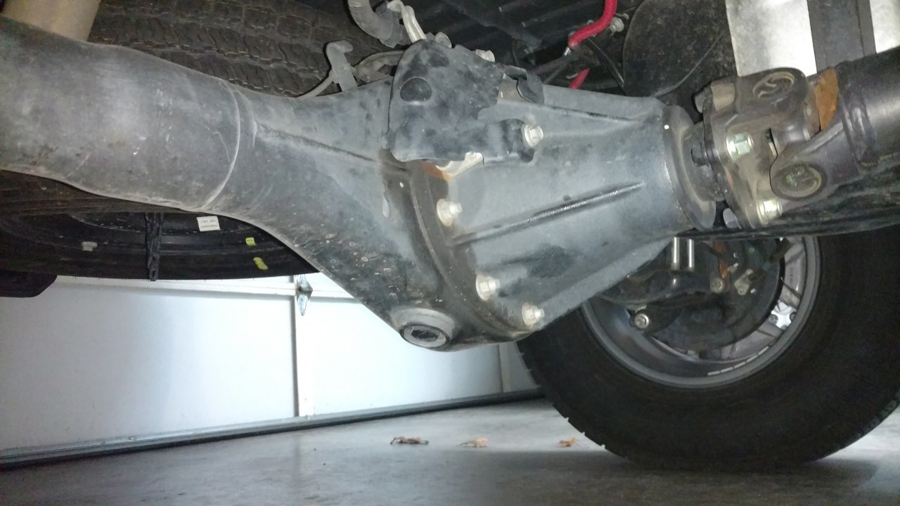

    I'm giving the gm one chance to fix this. I posted pics of my diff and a pic of the service report. I don't think I'm wrong on my diagnosis, but to be told what I was is unforgivable Imo. I have already been threatened with a carolla loaner. I got more bad news for him if he thinks that's going to happen. I use my truck for work, if a carolla could do what I needed, I would have bought a carolla.

    Finally took my truck in a few days ago for the differential recall. I checked mine after I heard about it on this forum. Mine had shown signs of seepage but no leak. Initially the dealers were holding the trucks even though they were not leaking. I did not take my truck in but kept in contact with my service advisor. It starting leaking a couple of weeks ago so my service advisor got me in right away (I took someone's place in line due to no call back). Fluid was not low so they just replaced gasket and bolts and finally got my truck serviced.

    My truck is not on the actual recall list. I checked the torque on the nuts... it was fine. I do see seepage though....no visible oil. I have 15,500 miles on my 2017....bought it in September of 2016...which falls in the production range for the recall. I guess I'm gonna take it in....how I absolutely hate my local dealer. I don't have any howling noise. What do y'all think?

    Now that things appear to have finally settled down some, I took my TRD/OR in for scheduled maintenance today, and also got my weeping pumpkin looked at. It was a most agreeable experience.
    I brought the weeping issue to my Service Associate's attention when I dropped off, and he said he would have one of the Lead Techs look at it. The Tech verified the weeping, checked my fluid level in the pumpkin (it was all good there) and they advised me that they were going to perform the gasket/nut replacement procedure under warranty. They had all the parts on hand, except the gasket, so that was ordered.
    I left the dealership in my own truck, and now just have to wait for a call when the gasket comes in, so I can drop it off again to have the whole thing wrapped up. The folks at Livermore Toyota have never failed to deliver awesome service!

    I took my 17’ sr5 in about 6 months ago. They torqued down the nuts and sent me on my way. 3 weeks ago I took it back because it had wet spots all around the edges. They replaced the whole diff and off I went... again. I took it back today because it was now leaking worse than it was before. Again, they replaced the diff and off I went. I’m going to be pissed if I have to go back there a 4th time and have another diff put in... again.

    Food for thought. When I heard to torque the nuts to 18 ft lbs., I thought that was very low especially since we aren't talking about a cover like most trucks. Here we are talking about the front housing for the differential. Just a regular cover on an F150 is about 35 ft lbs....and that's not a housing - just a cover.
    Is Toyota using a different gasket material?
