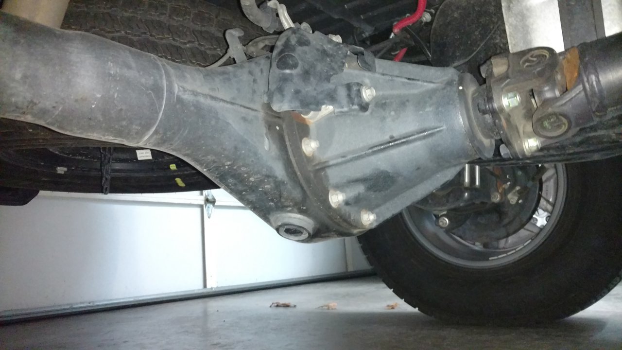

    Service advisor told me today. All rear ends were improperly over torqued from the factory. My OFF-ROAD eventhough it is not under the recall, the nuts we're over tightened from the factory. Seems like a quality control issue. I'm getting a new diff gasket...on special order. Should be here in a week or two. My truck came from the Texas plant

    I doubt your service advisor has a clue. One of the recall steps is on the diffs that show NO signs of leaks the procedure is to re-torque the nuts. Toyota has said from Corp they have implemented a re-tightening process at the factory. That is an under Torque condition.

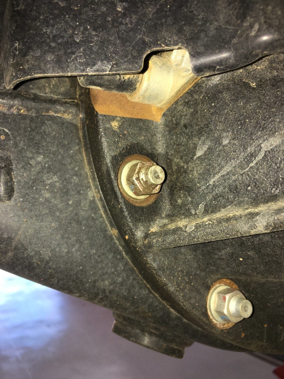

    Mine is weeping. I checked the nuts myself. They were definitely more than 28ft lbs. The oil is already getting past the gasket. The recall doesn't apply to Off-road or Pro trucks because they have 8.75" rearend, not the 8" like all the other Tacomas.

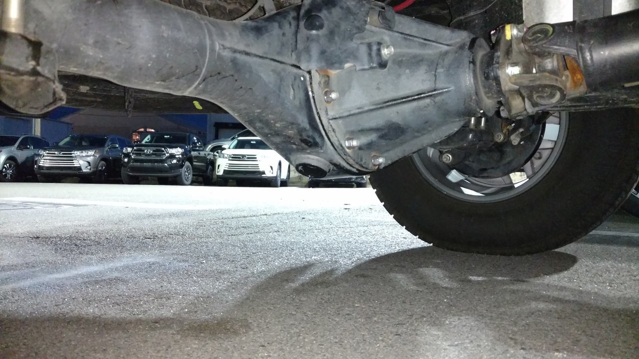

    Changed my oil the other day at 5k because the dealer refused to change it earlier. (facepalm) I had it up on the lift, and noticed some oil leaking around the diff seals. Im quite annoyed as the truck was at the dealer 3 weeks earlier for the first check.... either they didn't even check the diff, or they torqued it and caused the leak. I had checked it about every month or so and hadn't seen the leak before. lame.
    When I brought the truck in the first time I complained about the howl. Fortunately, it doesn't seem to bad on my rig. Only around 2k rpm freeway, throttle pulse. Of course they "didn't hear it." So today I went on a test drive with a mechanic to prove it. Chill guy actually acknowledged the noise and promised to look into it. Im glad to not be alone on this one. reaaaaaalllly annoying on a new truck.

    I got my truck back today with the new rear diff gasket...mine was not under the recall. OFF-ROAD and PRO trucks aren't included in the recall. The installed a new seal and torqued the nuts to 33 ft lbs. Said the factory has been over tightening the nuts. I had a loaner 2017 Tacoma Sport with 5700 miles on it. Rear springs squeak and I got that Clunk as you come to a stop at 12 mph just like my truck. Toyota just keeps sitting on their hands on these trucks!!! I would like to add my dealer experince was good today! Pic is after the repair.

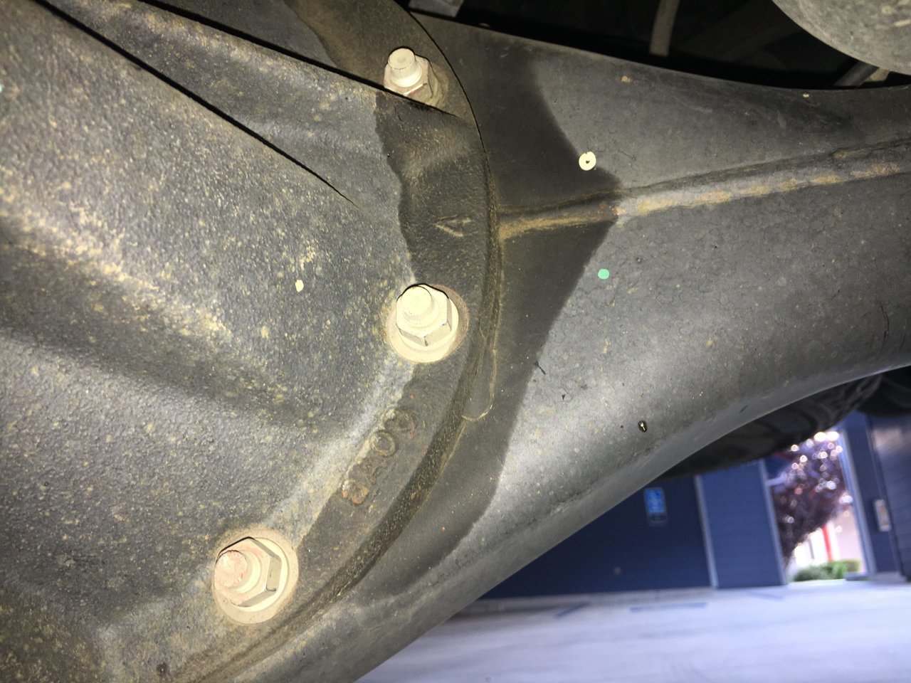

    Lol the dealer tried to tell me that the is "Normal leakage" from the differential!:rofl:
    I showed them Toyota's documentation and photos of what is considered a leak (e.g. "even a small seep is considered a leak") and asked them to reconsider. I told them that if it is not repaired I expect the service record to indicate "Normal leaking observed from the differential, and no action was taken."
    I then opened a case with corporate while the truck is still at the dealer explaining the situation. I am told I will hear of their determination in the morning.:annoyed:
