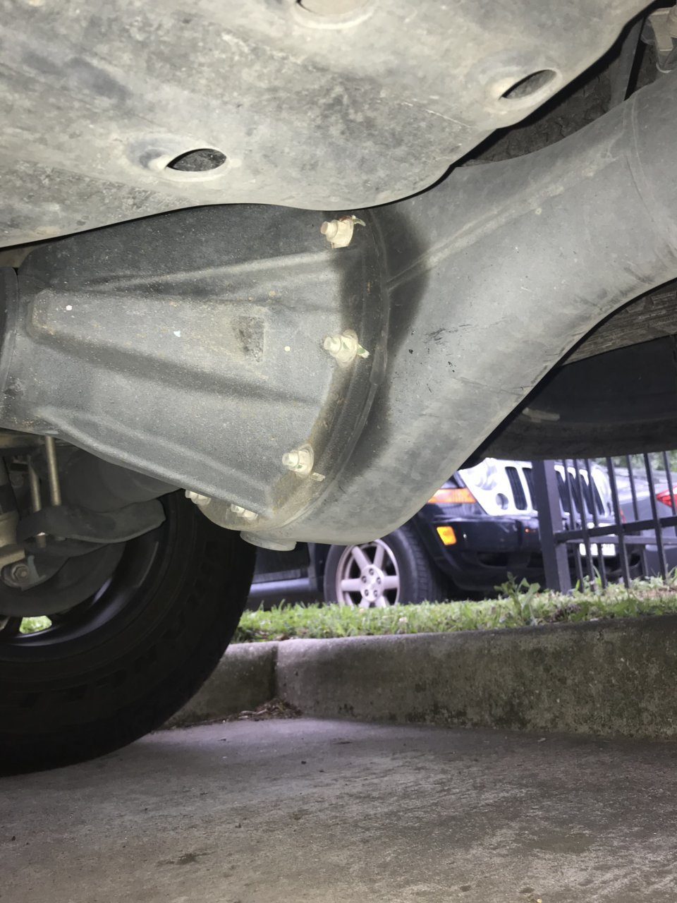

    I have the same issue with two small seepage spots on opposite sides of the bottom of the diff. 2017 sr5 dcsb 2wd. My truck was on the recall and had the bolts tightened by the dealer last May when the truck was new with only 1.5k miles. There were no leaks then, but I just noticed the two spots and I’m now at 15k miles. Dropped the truck off at the dealer today and should be hearing back from them on Monday

    Alesimo

    2020 Jeep Wrangler JLUD

    At 16k on the odo
