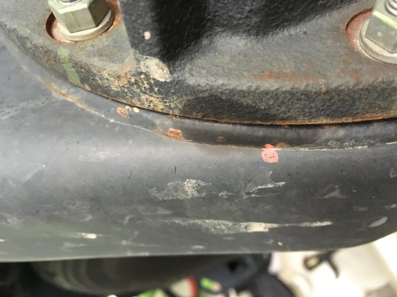

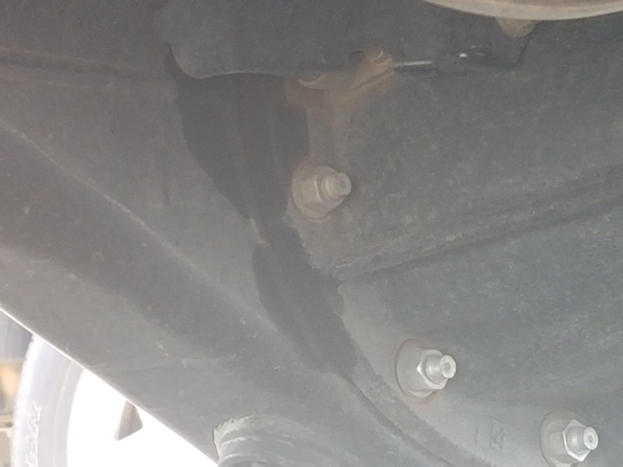

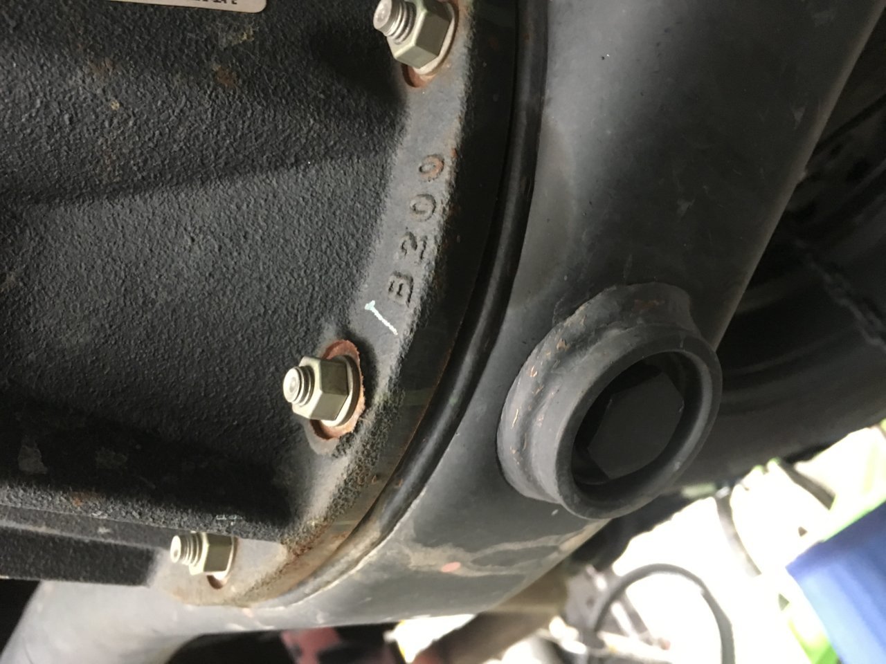

    Arrampico
    Arrampico Well-Known Member
    May 14, 2015
    #155256
    261
    Dan
    2018 4Runner SR5
    2017 SR5 Silver DCSB 4x4 V6 (RIP - Traded-in for T4R)
    So I’ve been having some issues with a very mild vibration when slowing down right at 20mph.
    I found this:
    https://www.tacomaworld.com/threads/low-speed-vibration.205207/
    post #5
    I’ve been through all the same troubleshooting with the dealer except the rear diff.
    I just crawled under my truck and have these:
    EB0C0353-E799-42CC-B56B-767BC97B1DCA.jpg 820333AA-E959-4495-8F84-9103B876AD25.jpg
    I think I’m going to the dealer again!
