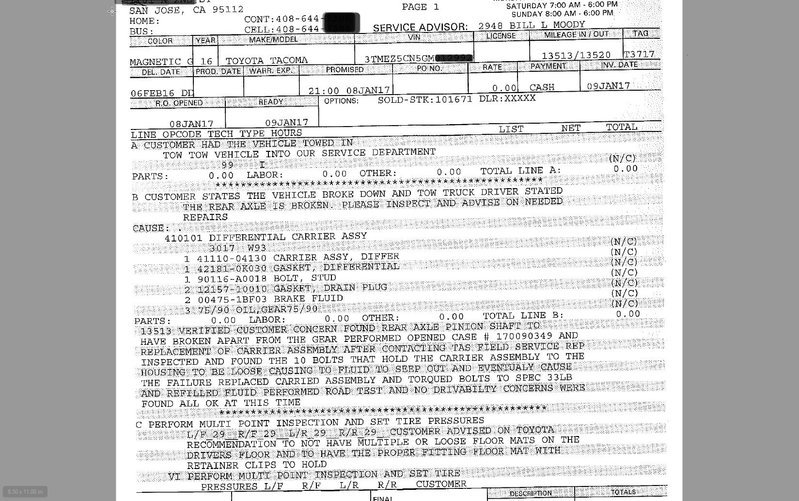

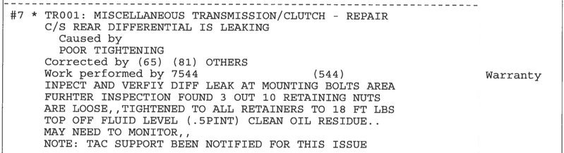

    Chatter here on TW suggests under-torqued third member to axle housing fasteners.
    EDIT: allowing the fluid to leak.

    That P/N for the bolt stud, tells me a few things.
    1- Looks like one broke or was determined to be no good during the R/R and they quietly put it on the work order, which gives even more credence to the theory that it's the studs that are defective
    2- NOW I KNOW WHAT THE PART NUMBER IS FOR THE STUD MUAHAHAHA... no for real that's a big deal, if it turns out that the studs are the issue and I decide to work up an aftermarket "Nitori's better recall" kit AKA buying ARP studs and having a performance shop bang out a swap and throw some AMSOIL in there, you've saved me a shitload of legwork. :)

    Here's some more information

    I'll wait till they have parts before I take my SR in. Looks like it's the studs braking when tightened to spec. So I am not taking my truck in till they have parts it's not leaking at all. I can't work if they end up keeping it. And I can't put a 28 foot ladder on my off road.
