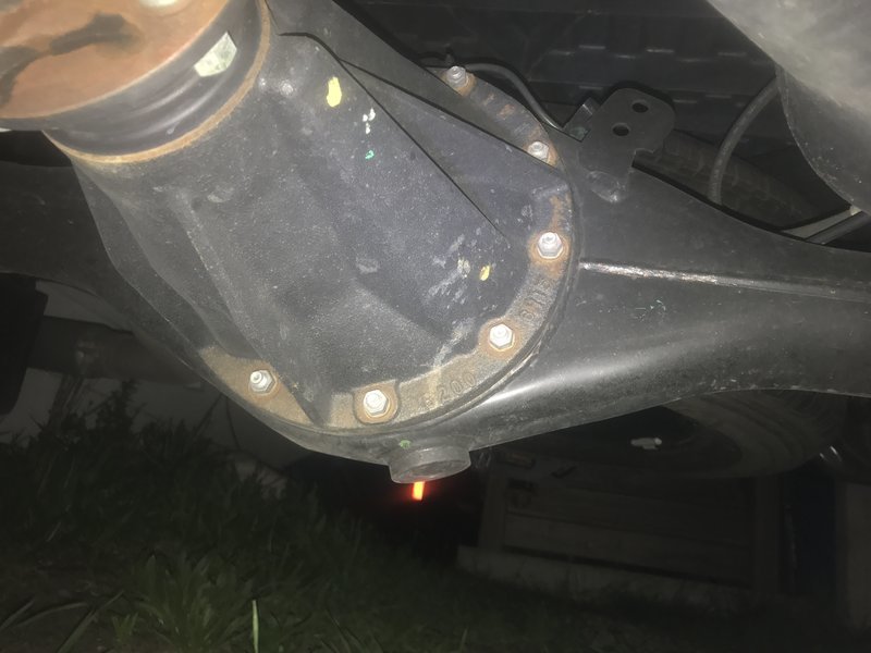

    Not on the recall list, not coming up on my Toyota app. But a quick peek reveals something else.

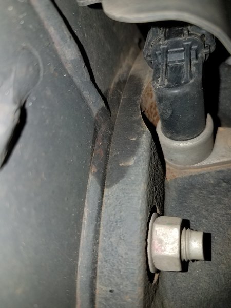

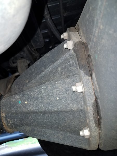

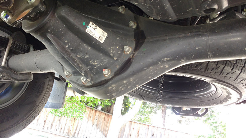

    Here's what my 2016 TRD Off-Road diff looks like right now...
    Manufacture Date: 06/2016
    Hecho en: Mexico
    Mileage: 3,715
    VIN is NOT on the recall list (as of yet)
    I gots the diff-sweats! Looks like it goes all the way around, but no noise as of yet... :fingerscrossed:

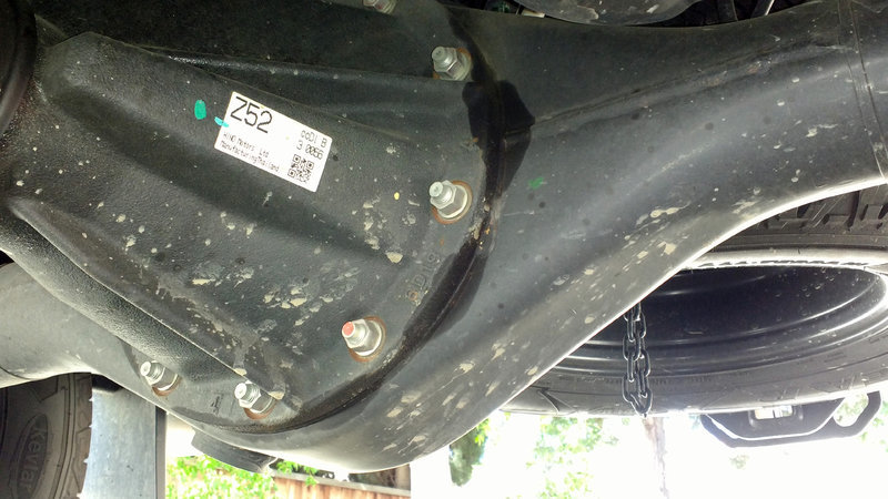

    Hi Everyone.
    First post :)
    Less than 2700 miles on the truck and not on the recall list.
    Hopefully the pic attached.

    Not on the recall list, yet. I'd get that looked at

    Getting it looked at next week. The thought of it locking up at freeway speeds terrifies me

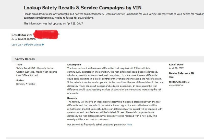

    IMG_5580.jpg I'm on the recall. Suck ass...built 11/16. 4300 miles no signs of leak.
