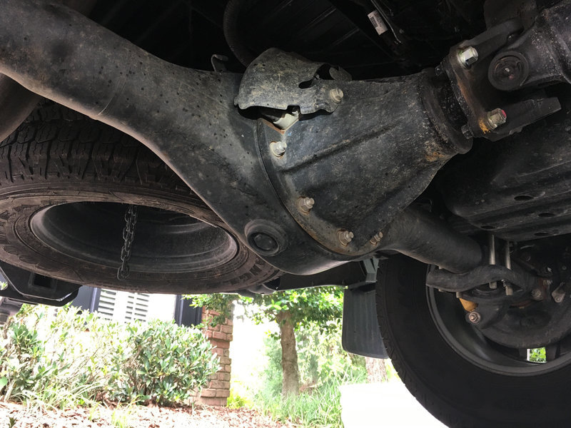

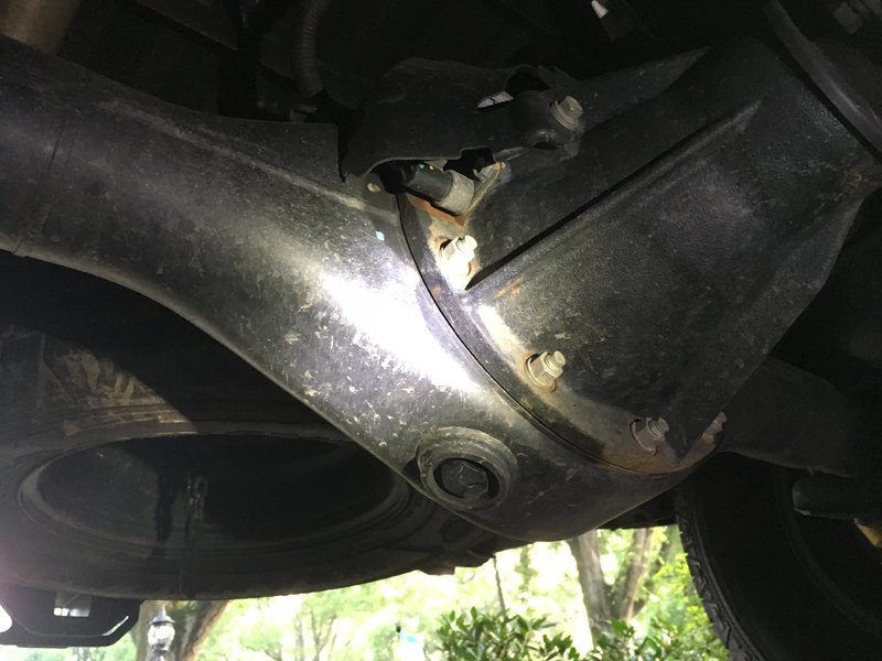

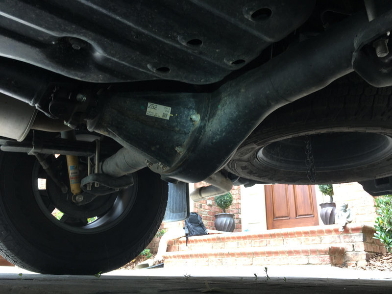

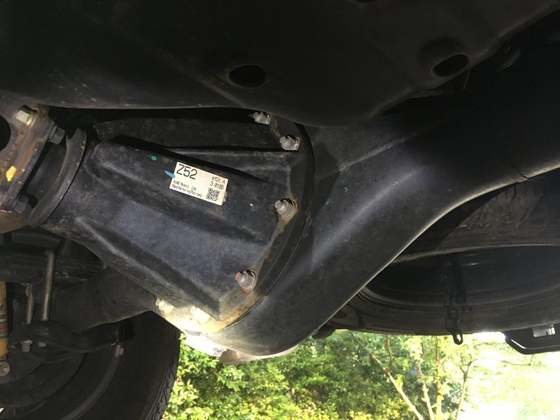

    So I just checked my VIN. I'm not in the recall. I am scheduled for my 15k service tomorrow at 8a.m. and figured I look underneath. Found some wet spots....Also has anyone performed this recall with Hendrick Toyota of Concord?
    Should I postpone?

    If you are not on the recall, it will just be treated as warranty work.

    That's just pitiful assembly. I believe they are really slapping these trucks together. Toyota cant live on it's die hard reputation forever if they keep cutting corners with cheap parts and labor.
