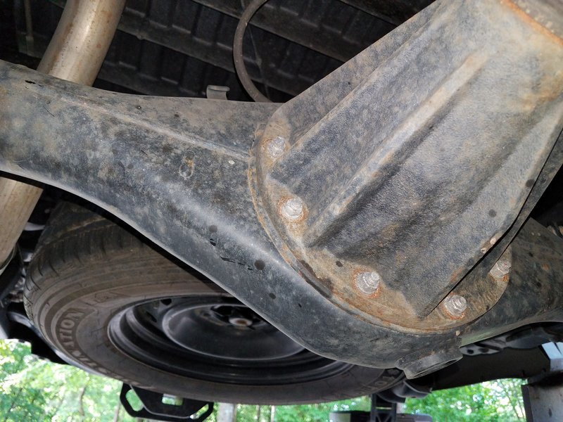

    Dude, is that a '16 or '17? Do you live in the rust belt?

    1,587
    Georgia
    I have been surprised at the amount of rust in the pictures on some of these low mile trucks.
    And they are not in rust belt areas.
    Thin paint?

    16 TRDOR DCSB (SOLD)
    Mine had more rust than I would like, and I live in Virginia.

    2020 Ram 2500 Power Wagon; 2019 Land Cruiser
    VA brines the shit out of the roads. I fluid filmed and my frame is in much better shape.
    My previous vehicle was a 2010 4Runner Limited (actually made in Japan), and after year 3, I couldn't get a bolt turned under that truck without a 3 day pb blaster soak. I learned my lesson and now I fluid film twice a year and rinse the under carriage after every instance I see brine on the roads.
    Toyota is notorious for doing a shit job on rust prevention.
