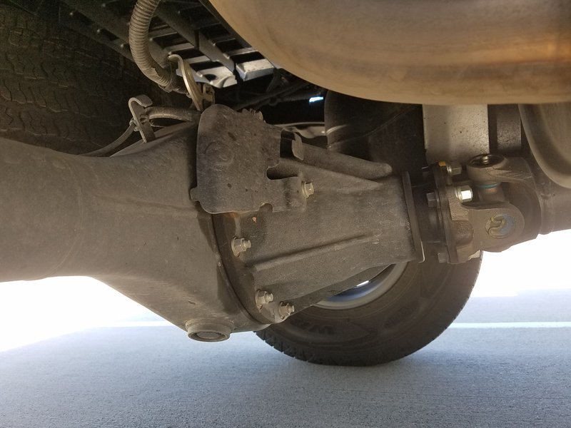

    Can anyone definitively settle the torque specs? Pics both show 1 way or another but based on bolt strength, there is no way I can see torquing an M10 less than an M8 bolt. The OR/Manual/Locker model with the 8.8" rear end and M10 bolts should be IMHO up to 33 ft lbs which is what the bolt is rated for and the Non-locker/non-diff lock with the 8" rear and M8 bolts should be up to 18 ft-lbs which is what those bolts are rated for*
    *based on class 8.8 fasteners.

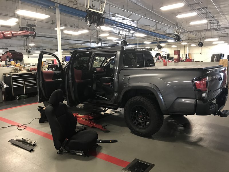

    Took truck in for 10k mile service. Apparently I was the first one service rep had seen with the weeping diff. He had no idea there was a recall out. Agreed to give me a loaner for the night (rav4) and techs would call hq in the morning. To be contd.

    As far as I can tell there was an error in the repair manual previously. The repair manual was corrected/updated on April 26, 2017 on TIS. As of right now for 2016-2017 models, all M8 applications (automatic transmission without locker) list 18 ft-lb and all M10 applications (manual transmission and all models with locker) list 33 ft-lb.
    My other post which was quoted has the most current, up to date information.
    Jeff

    Thanks. I will stop spreading missinformation. #fakenews.
    18ft-lb seemed pretty weak.
    My goal is "as tight as I can manage plus 1/4 turn".

    731
    Awesome thanks for the update!

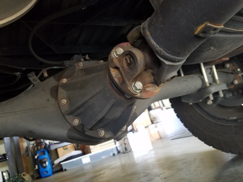

    I got my truck back. It was not on the recall list but the diff was leaking. They replaced carrier gasket and drain&fill plug gaskets and tightened the M10 sized thread carrier nuts to 33 ft-lbs for the rear diff locker.
    I bet someone at the assembly line got confused and was setting the torque drivers to 18 ft-lbs for these.
    But so far so good. I'm really happy to be back in my truck.
