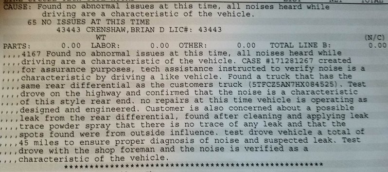

    Took mine in for 5k service, SA immediately brought up the recall and is the first think he checked, which I already knew I wasn't part of. I did mention I had a small amount of weep. They cleaned and applied
    trace powder spray" drove it 45 miles(which I approved) and said it was from outside influence. Also brought up the diff howl which they confirmed they heard and after opening a case and confirming howl on another vehicle they verified it was a characteristic of the vehicle. My SA called me after I picked up the vehicle saying he thought it was BS that the sound is a characteristic of the truck and a new truck shouldn't be making that noise but there is nothing he can really do. My main goal was to simply have both documented and I will continue to monitor weep and keep looking out on recall status for Pro's. I also had my oil/front/rear diff and transfer case fluids drained and replaced as I do on all my new vehicles after break in.

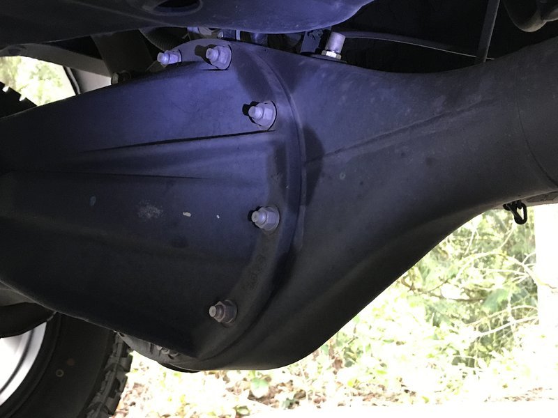

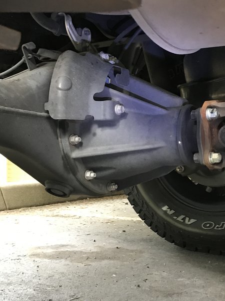

    This is what I am prepared to deal with. I got the call today that its ready to be picked up and they echoed the sentiments that are listed in your write-up. They left me a voicemail yesterday along the lines of "we didn't here any *abnormal* sounds from the rear end". My guess is they are about to play the "its normal" card. I opened a ticket with corporate last night. They said a Customer Relationship Manager should be calling me today or tomorrow. I haven't heard a peep yet.
    My differential has obvious weeping (some of the more egregious weeping I've seen actually). "It showed no signs of an active leak and we didn't see any seepage." and, quite miraculously, my howling differential isn't howling anymore for these guys. "We dont hear any weird sounds at all."
    I was pretty blunt with the service rep today: that's not a suitable answer and they'll have to explain to me how this isn't evidence of a problem with the diff: [​IMG][​IMG]

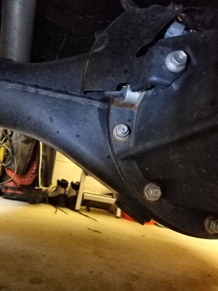

    Crawled under mine even though my VIN isn't on the list. Saw this....
    Debating if I risk having it held hostage.
