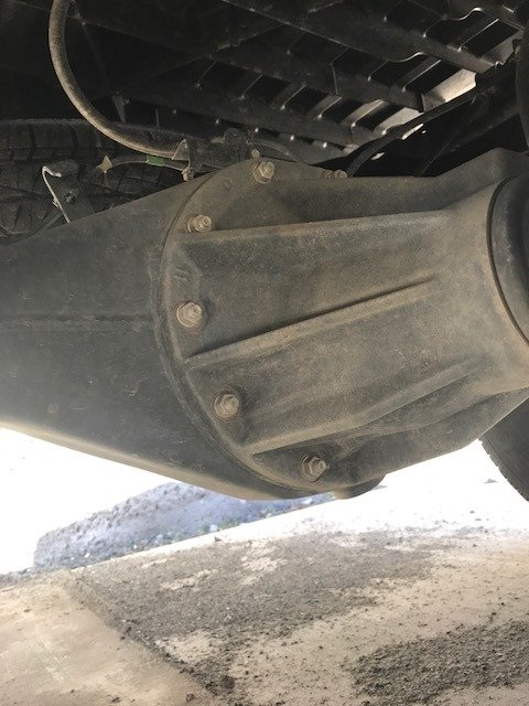

    Does this just pertain to the rear? I have a 17 ORDC with 7k miles and I put some RCI IFS/Trans skids on this morning. When I pulled off the factory tin sheets I noticed my front Diff (I think :fingerscrossed:) was leaking out of the drain plug. It's the only picture I took. Were just the rear diffs affected by the recall or are there problems with the front as well. Sorry for the shitty pic. Was a tight fit, only parked driver side front tire up on the curb. The left is the front and the right is the rear. IMG_6864.jpg

    mike2810 Well-Known Member

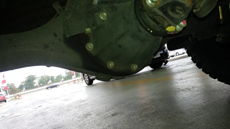

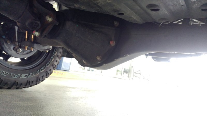

    Apr 23, 2015
    #153765

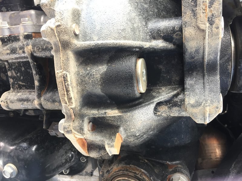

    Houston, TX
