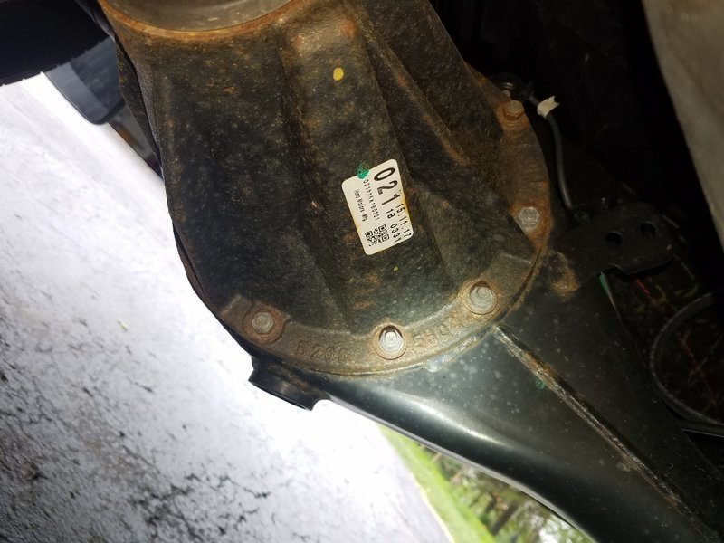

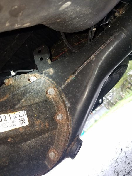

    Taking mine in Monday for oil change and other various issues including rear diff. Going out of town next Friday for Memorial Weekend and have a few trips in June/July. Here are some pics, I don't see any leakage, but what do you think from your own experiences so far??
    Thanks!
    SilverII likes this.
  11. May 20, 2017 at 9:41 AM
    #1431
    The hammer
    The hammer Who’s the Wrench?
    Mar 7, 2016
    #180475
    3,880
    '16 Tacoma SR5 4X4 DCLB TSS Pkg 17X8" BSW-Cooper DIscoverer AT3 4s P265/65/17
    Underworld Flex trifold, tinted, TRDPRO grill, TRDPRO shift knob, etc,etc
    No leak found at this time, set the toe and let it go!
