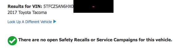

    I'm going to take mine in for it's 10K service tomorrow and will ask what they plan to do about my weeping. It's a TRD-OR so it does not show under recall. I'll keep everyone posted.

    ^^It may become the new "Normal" ^^ Just saying...

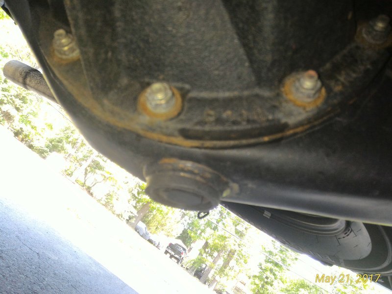

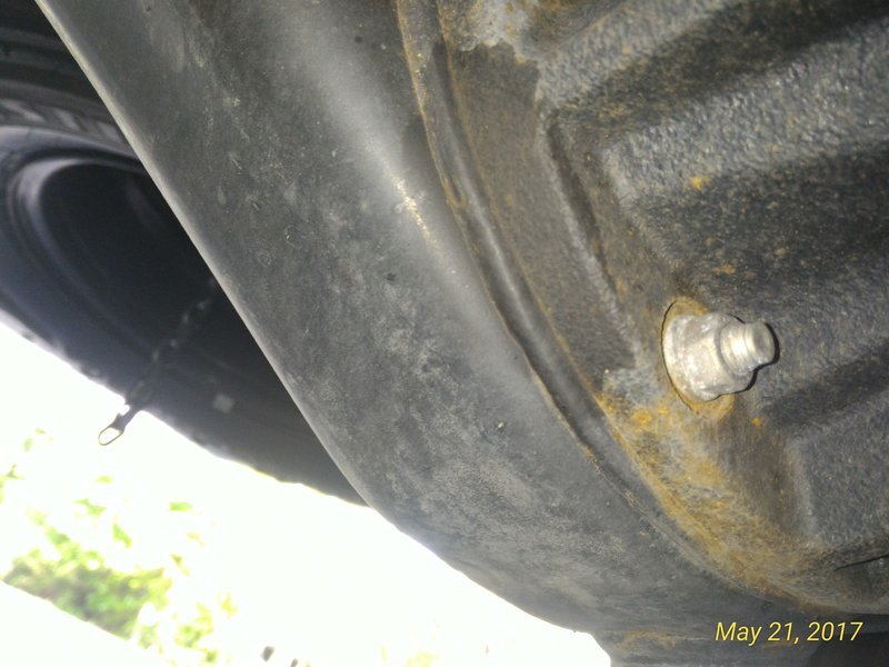

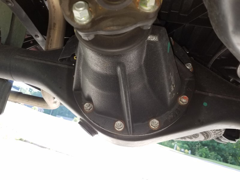

    Thanks to this site, posts and comments. I was prepared for the dealer. I was do for my 15K service put my VIN thru and I was on the recall list. Looked at my rear and took pics. My truck was going on 1yr anniversary this past memorial day weekend and I did not have it because the dealership was told to keep my vehicle. They put me in a fully loaded FORD F150 from enterprise. It has been a little over a week and got a call from dealership. They told me they still have no update on fix or when it might be completed. My leak does not look that bad but I do not want to damage the vehicle by driving it because I plan on having it for a long time.
