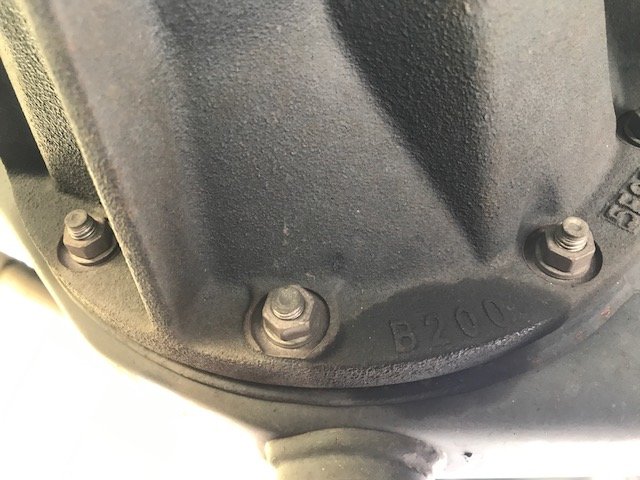

    IMG_1900.jpg While I wait for them to sort this out I torqued down everything hoping to slow my small leaks. Figured I lost a little so I picked up a liter can of rediculously overpriced Toyota differential oil to top it off. It took the WHOLE CAN!!!!!!! Truck was definitely level. Less than an ounce left before it overflowed the fill hole.
    Anyone holding out for the official fix, top it off! Unless you're actually trying to burn it out and get a full differential swap. You'll need GL-5 75w-85 diff oil, a 24 mm socket, crush washer, and 36ft/lbs of muscle if your interested.

    Not going to go back and look, but I think there was a least one lock-up here on TW.
    G.

    :eek: 36 ft. lbs..........don't you have a Sport?

    I think what he meant to say is 36lbs is for the diff fill plug since that is what it's supposed to be.

    I think the amount needed to fill it back up needs to be emphasized.
    There was another on here who had what appeared to be a minor leak and it also took the whole can to top it off.
    Even though some of these leaks look minor, it appears that quite a bit of the fluid is seeping out.
    Or else they were never full from the factory (now where have I seen rumors of Tacoma mechanicals not being topped off from the factory?).
    Either way, don't just torque the bolts and think you're good if you have a minor leak. Check it to be sure!

    hope so! don't want to see another snapped diff bolt.
