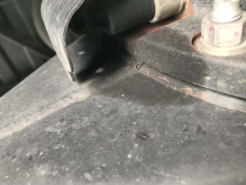

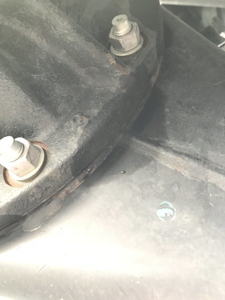

  12. Jun 4, 2017 at 10:44 AM
    #1672
    dYL0n
    dYL0n أنا لست الإسلامي
    Jan 14, 2011
    #49250
    4,595
    Dyl0n
    New Orleans, LA
    17TRDORDCSBQSJBLKBRO2SPECU1.04
    1.04. Kbro2s. ICONS.
    Uh... it was fine a month ago..
    And I checked my vin just now, it says no open safety recalls. WTF.
