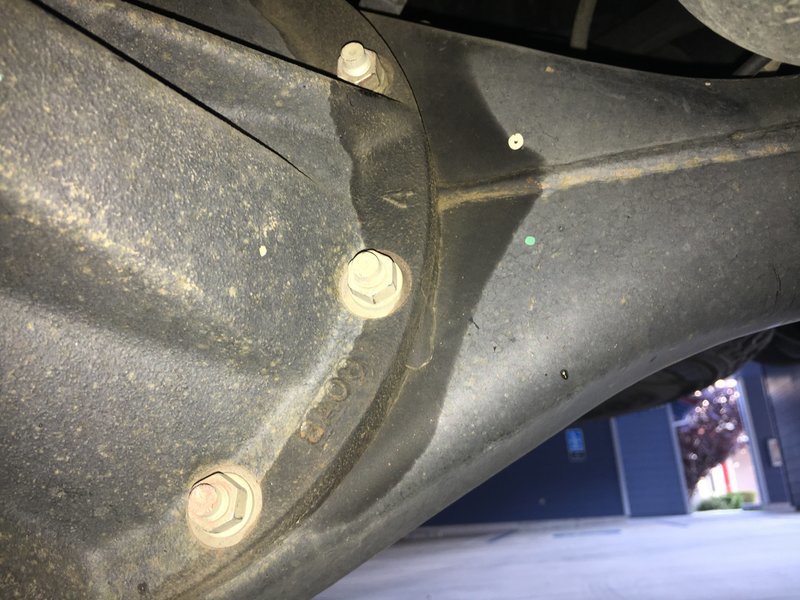

    I just made an interesting discovery. 2016 TRD/OR, 2WD with a slight howl at 55-65:
    I am not on the recall list. As you can see I have the sweating. I confirmed that all the nuts were torqued to 33 ft-lb. then I opened up the fill plug to check the level. As the plug backed out, I heard a sucking sound that got louder and louder as the plug backed out. When I eventually pulled it out, there was a whoosh as air rushed into the diff. Sounded a lot like when you open your gas cap.
    So, the oil level was ok....maybe slightly below the overflow, but certainly enough. So I put the plug back in and went about my business.
    Now, two things happened:
    1. I am pretty sure the howl is gone, though I have to confirm this over a longer period of time
    2. the sweating has gotten worse in a 20 mile drive.
    I am speculating that over time when the diff heats up and the fluid/air inside expands, the pressure increases. then, some fluid and gas made it past the gasket, equalizing the pressure and causing the weep. Then after cooling down, the pressure decreases, causing a vacuum in the pumpkin (this is when I checked it). After the vacuum is released, the pressurization cycle begins again, worsening the sweating as fluid and gas is pushed out.
    I will be monitoring and waiting for the ORs to be added to the recall.

    Check your differential breather on top of the housing that little silver item. That's to prevent exactly what you say is happening it allows pressure to escape when it gets built up.

    did you have any visible seeping?

    When I took my Taco in several weeks ago to look at the rear diff, the service advisor walks me to my truck and said it is bone dry. The technician and advisor are standing there showing me the drain plug side.
    Yup, that side is bone dry. Now take a look at the other side. Ohhhh.
    They tightened the bolts, cleaned it up and sent me on my way. I should take a look to see if the seeping has started again.

    No seep whatsoever. Will keep an eye on it for any future weep.

    As far as I know, no leak = tighten bolts and inspect ; signs of leak = hold till fix (gasket and hardware) come in.
    Guess I was in the lucky group of inspect and retorque... but with the same faulty hardware and gasket who knows if that's the end of the story

    Thanks for the suggestion. Looks like that is a spring-loaded check valve that lets pressure out, but does not let air back in. So I guess a little vacuum in the pumpkin is "normal."
    Evidently real 4x4ers replace this with a 2-way breather, relocated somewhere high so that the vacuum does not develop, potentially sucking water in through the axle seals. How the seals can pass water but not air I have no idea, but they seem to be convinced. I'm also suspicious that they all refer to the diff cooling "rapidly" causing the vacuum, as if slowly cooling after returning from the grocery store is any different. Not sure they've thought this all the way through. Either way, I don't cross deep water so I'm leaving as-is.
