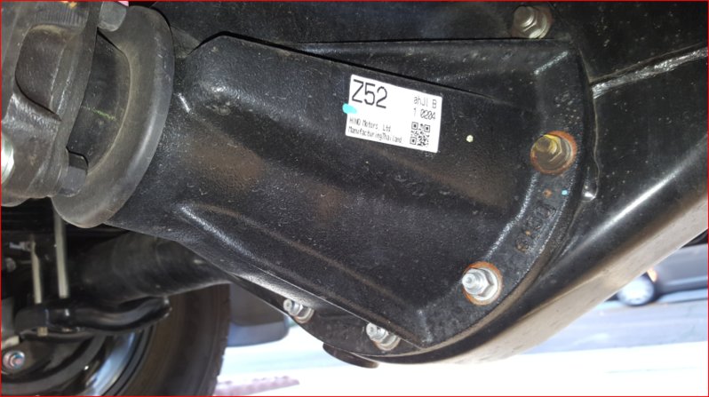

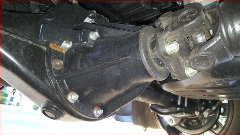

    Dacon
    Dacon 2017 Tacoma TRD PRO Quikrete
    Dec 20, 2016
    #205354
    2,932
    Danny
    Gilbert, Arizona.
    2017 TRD PRO DCSB. DOP 02.20.2017
    TRD PRO Cement 2017 TRD CAI and AFE Magnum Flow Dry Air Filter Camburg KINETIK Series Billet UCA Icon LCA skid plates Icon Coilover extended travel shocks with 700# springs Icon 2" rear shocks Icon RXT leaf springs full pack (new rims and tires soon)
    Have finally checked my diff and all good.
    vale46 and SilverII like this.

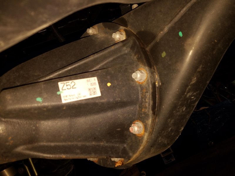

    pkang0915
    pkang0915 Well-Known Member
    Apr 3, 2017
    #215268
    519
    Bay Area, California
    2017 Tacoma DCLB OR (first time Taco owner)
    TOYTEC 2.5 kit, SPC UCA, N-fab side steps, TRD pro grille, FN FX PRO Wheels, BFG KO2S (265/70/17 C Rated), TRD Skid plate, Tyger Tonnue Cover, OVtune, Borla S type exhaust
    Says my truck isn't part of the recall. Just went under it right now just see rust spots on the lugs. Looks like i might see some "wet spots" at the top of the differential but can't really tell. going to take it in anyways.
