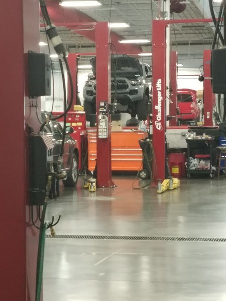

    Inspection was done in about 20min. All nuts already at 33ft-lbs. They said they would open a report with "California". I assume that is Toyota Corp.
