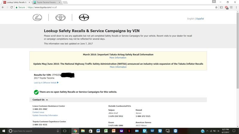

    This is from two days ago and still says the same thing today. But yes of course will be taking it in.

    That's because OR's aren't on the list...........Yet....

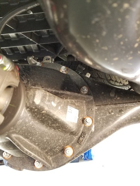

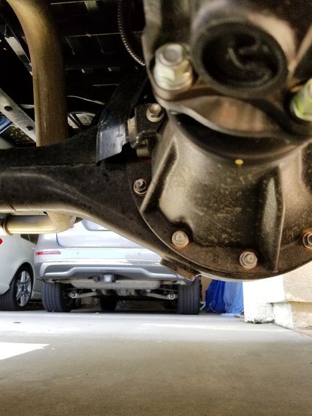

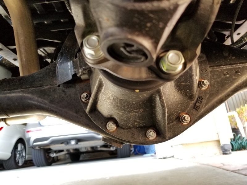

    Based on this description:
    Description of the Defect : The subject vehicles are equipped with rear differential carriers assembled to rear axle housings. Due to potential sealing surface contact variation, there is a possibility that the sealing performance may degrade and the nuts fastening the differential carrier to the axle housing may become loose. If this were to occur, the rear differential may leak oil. If the vehicle is continuously operated in this condition, the rear differential could become damaged, which can result in noise and reduced propulsion. In some cases the rear differential could seize, resulting in loss of control and increasing the risk of a crash.
    Due to potential sealing surface contact variation: This may indicate that the rear carriers are defective... And the simple buy costly and stockholder price damaging fix of replacing the carrier is what the hold up is. Toyota is probably scrambling for a workaround fix so they don't have to do this. They already are having to make new frames for 2nd gen Tacoma's and Tundras.
    In the very beginning of this recall someone posted that they spoke to someone they personally knew at corp, and that what was said is Toyota is very stressed because they don't want to have to replace all the rear ends.
    The legendary reliability of the Tacoma was established with the 1st and some 2nd gen trucks. Now the 2nd Gen trucks have taken a huge it with many of the frames having to be replaced (my 2006 included) and it is now being forced on them by a class action lawsuit settlement where before it was voluntary service campaign. Toyota tried to say it was the excessive salt, but when the same problem cropped up in non salt states, same problem.. It was a poor design.
    My truck is also on the recall list, and has signs of seeping around the carrier. It looks like old seepage and not fresh. I got lucky in that the recall came out 1 hour after I left the dealer for my 20K service. I checked the rear fluid level and it is fine. I am just going to keep a look out on it until a real fix is in place. After my 9 month frame recall wait, no way in hell are they going to hold the truck again.
