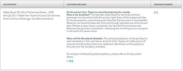

    It's taken 5 month but Toyota has finally made the remedy available for this recall...
    SAFETY RECALL D0L
    Vehicles Affected
    All 2005-2011 Access Cabs
    Condition
    The Seat Belt Assemblies for the driver and front passenger are mounted inside the access (rear) doors
    of the subject vehicles. On the assemblies, screws holding the Seat Belt Pre-tensioner to the Seat Belt
    Retractor can become loose over time and through forceful repeated closing of the access door. If these
    screws loosen completely, the Seat Belt Pre-tensioner and Retractor Spring Cover could detach,
    increasing the risk of injury to an occupant in the event of a severe crash.
    Toyota's Remedy
    In late December, 2013 Toyota will send an owner notification by first class mail to owners of vehicles
    covered by this Safety Recall.
    Toyota dealers will perform an inspection of the seat belt assembly and replace the four screws at no
    charge to you. If all four screws are found loose during the inspection, the dealer will replace the seatbelt
    assembly at no charge to you.
    More information can be found in the official remedy notice https://techinfo.toyota.com/techInfoPortal/staticcontent/en/techinfo/html/prelogin/docs/cp/d0ltofaq.pdf
    UPDATE
    Went into the dealership to have this done... took about 2 hours. Here's what I had replaced:
    QTY PART
    2x__04003-37135 SPRING KIT, SEAT
    2x__04003-37235 SCREW KT, SEAT B

    My drivers side belt fell off the access door 3 months after I bought her, I just took a pair of skinny vice grips to tighten the screw back down, guess after they get the paperwork done & mailed out I'll take her in and have them "fix" it & have a few free donuts while waiting. :rolleyes:

    According to the FAQ you won't have to wait til notice is received in the mail... you can print it up and bring it to the dealer so they can verify you're covered and then fix the seatbelt.
    I'll post up the remedy from Toyota's site once released.
