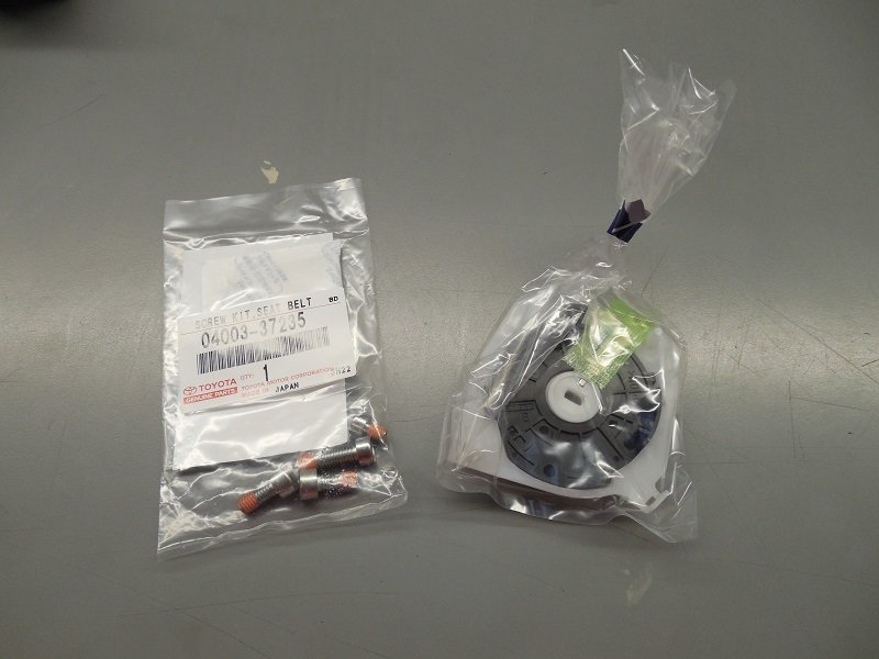

    Scheduled service with my local dealership for "Toyota Recall D0L Seat Belt Assembly". I was the first person thru the service bay doors and it took 2 hours to complete the recall.

    Yea, they pull the door trim to get to the seatbelt. Check the OP took about 2 hrs and I included the parts they replaced.

    Sorry, I know this thread is a couple days old, but here is what Toyota replaces:
    The screws are the culprit, the new ones feature a threadlocker on the threads (the orange bit). If these screws come loose, the spring (on the right) isn't held in place properly, and comes apart, like this:
    Hope this is illuminating.

    Red Locktite.

    Very illuminating, thanks! :thumbsup:

    Not quite. The screws don't hold the spring in place. The spring cover has been redesigned with ribs to prevent the screws from backing out very far (i.e. provides redundancy in case the loctite fails). That's why the spring is replaced as part of the recall.
    The work instructions are posted on NHTSA's recall web site:
    http://www-odi.nhtsa.dot.gov/acms/cs/jaxrs/download/doc/UCM449351/RCRIT-13V337-4819.pdf
    The technical content starts on page 16 of the PDF. It's somewhat invasive, involves opening the seat belt retractor assy (i.e. more than what an assembly line worker would do to install seat belts). The technician has to completely unwind the seat belt from the reel, "time" the shaft to engage the new spring, then pull a grenade pin to release the spring tension.
