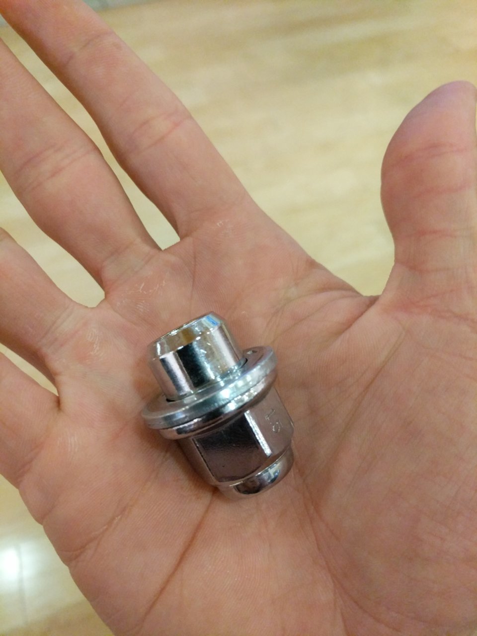

    Those are the type of lug nuts used with hub centric wheels, and most OEM wheels are hub centric.
    That type only holds the wheel on, all weight is supported and the wheel is centered by the hub.
    Most aftermarket wheels are going to use the tapered or conical lug nuts which are lug centric
    With tapered type the centering is done by the lug nuts and the weight is also supported by them.
    Are the 4Runner wheels hub centric?
    Is the hub the exact same size as the Tacoma?
    If they put the wrong type lugs on it could very well be your problem.

    Not sure if true, but I was told that the Toyota OEM alloy lug nut is a combination of hub-centric and lug-centric, so that the same lug nut can be used on the spare steel wheel in emergencies.

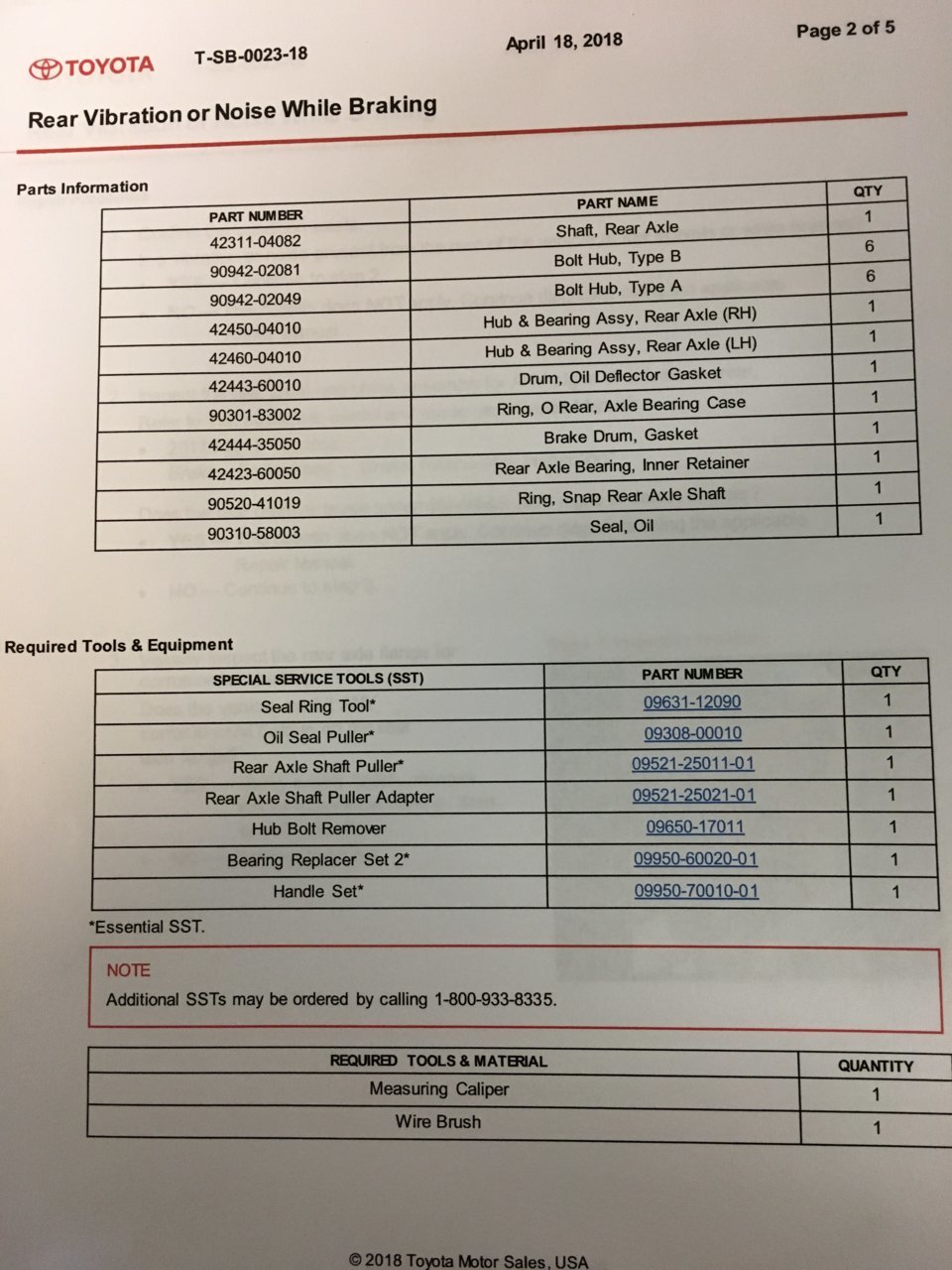

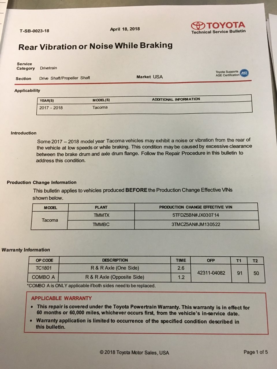

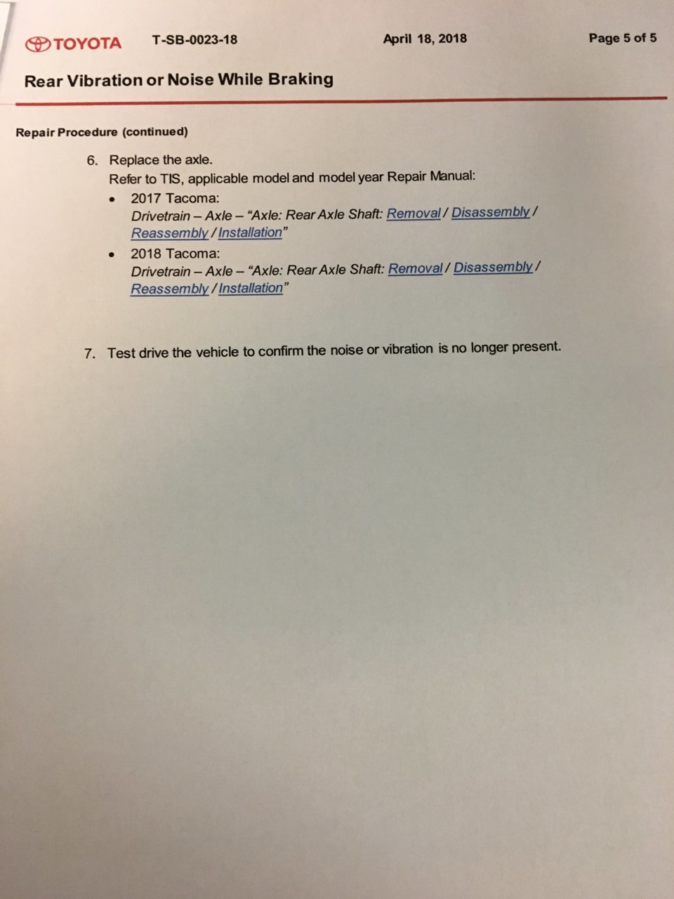

    The TSB was released by Toyota USA today. T-SB-0023-18:
    The repair procedure involves replacing one or both rear axle shafts, wheel bearing(s), seal(s) and associated components on the rear axle. Covered under the powertrain warranty (5 years, 60k miles/100k kms).

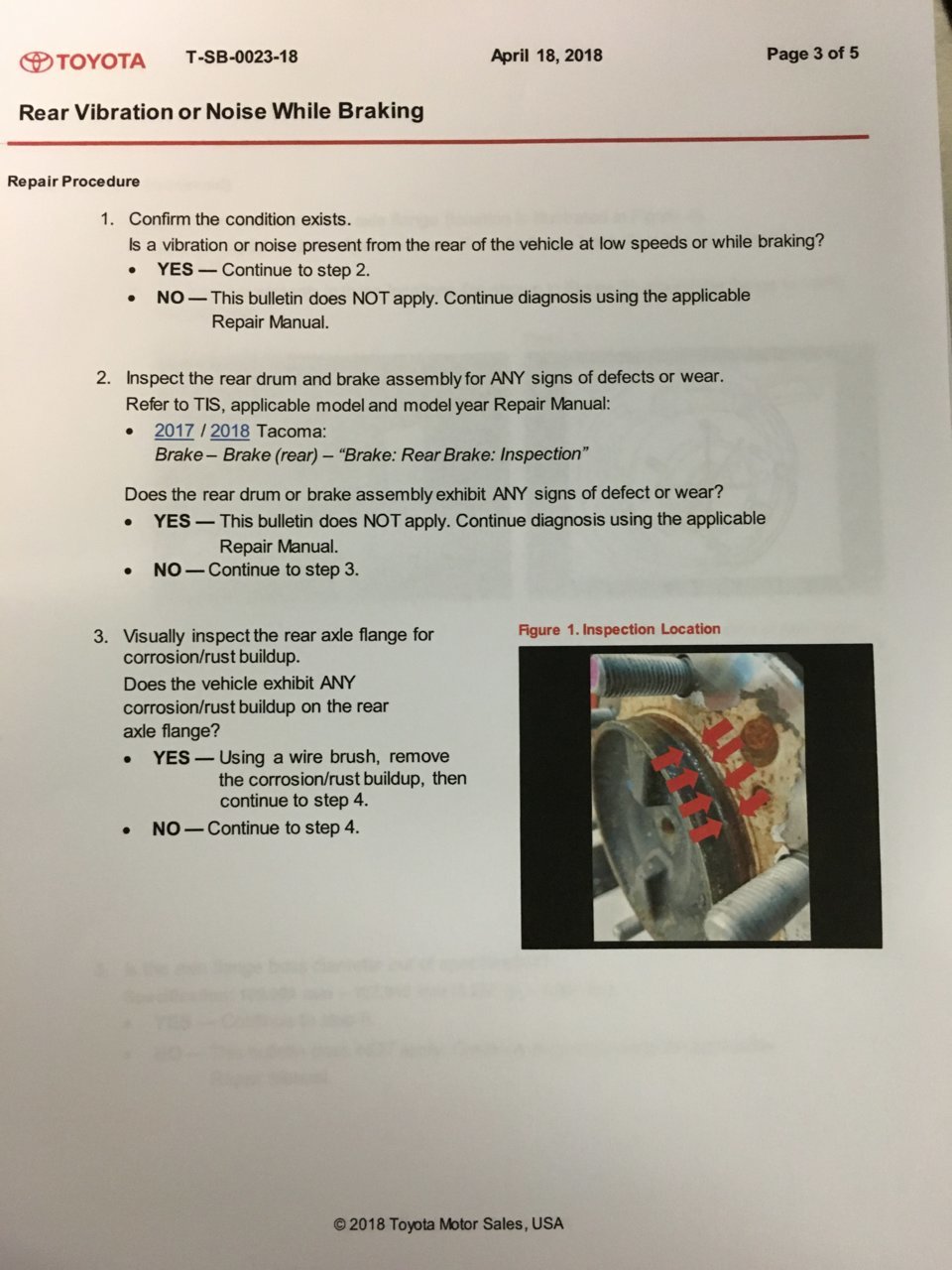

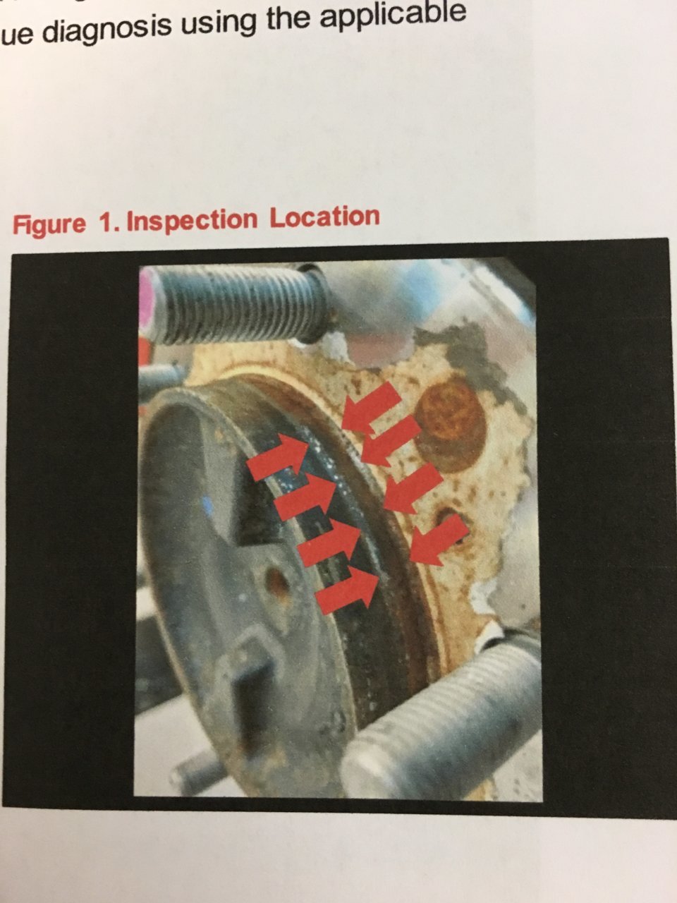

    I dont see anywhere it specifies what kind of noise in the tsb just says "Is a vibration or noise present from the rear of the vehicle at low speeds or while braking?". Then it just goes on to inspecting the axles check for rust build up and acle diameter.

    I have the tsb but i dont know how to get it on here. Its on a thumb drive right now.

    Couldnt upload the file it was the wrong type of file jpeg i think, so i just printed it and took pictures i hope this helps. Ill be checking mine to see if it needs it or not soon my brakes are vibrating didnt think much about it untill now tho.

    l got in an argument with a guy at the tire store because I had the spare on with those factory lugs, he insisted they were incorrect but the taper at the end allows them to work.
