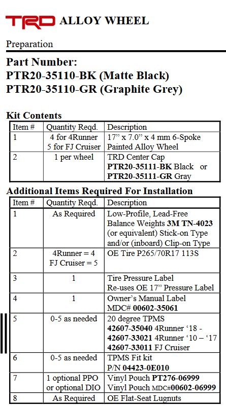

    Cannot use "tapered" otherwise know as "Acorn" nuts on 4runner TRD wheels. The 2018 Tacoma OR wheels use the flat seat bus seen in Post 14 and refereced above.
    That means your dealer likely is wrong. The bugs in your photo are correct for the TRD wheels from the 4 runner

    This is good to know. I'm receiving 4Runner TRD Pro Wheels today and was wondering about this.
