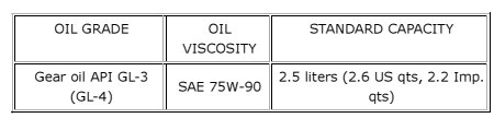

    Haynes 2nd Gen manual says the manual transmission gets 1.9 quarters. Where did you get the figure 2.3? Thanks.

    The 12,000 page Tacoma Service Manual PDF says 2.6 quarts. Where did this guy get 2.3? Someone should take this down unless it's validated.
