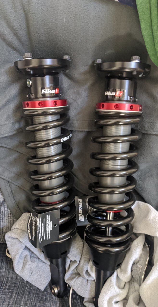

    Just received my 2.5s for 2-3in of lift! The way I'm reading is this should be set from Elka at 2.5in of lift? Im guessing I may need to adjust it depending on extra weight to get my desired height. I also don't want to do any damage to the CO by doing the adjusting, so it's best to jack the truck up to relieve compression before adjusting? Or should I be removing the entire CO and have them adjusted with a spring compression tool in the work bench?
    These are my first set of true COs as I'm currently running 5100s and 887 springs. I just don't want to screw anything up when trying to adjust them.

    They can be adjusted on vehicle. Raise wheels off ground to relieve spring tension. Lube everything with wd40 or similar. Back out the set screw til its loose, then screw it back in til it gets a little tension. Make your adjustment. If you see that the collar has skipped a thread, pull the shocks off the vehicle and compress the spring to correct.

    For a very minor adjustment yes it “can” be done on the truck but it really needs to be done off. Which sucks ask me how I know lol

    Yea, the more I read and asked on a few sites, the consensus seemed to be to just remove them to save yourself any headaches. Alluminum is soft and I'd rather play it safe.
    Trucks rides great with barely any preload on the 650lb coils.
