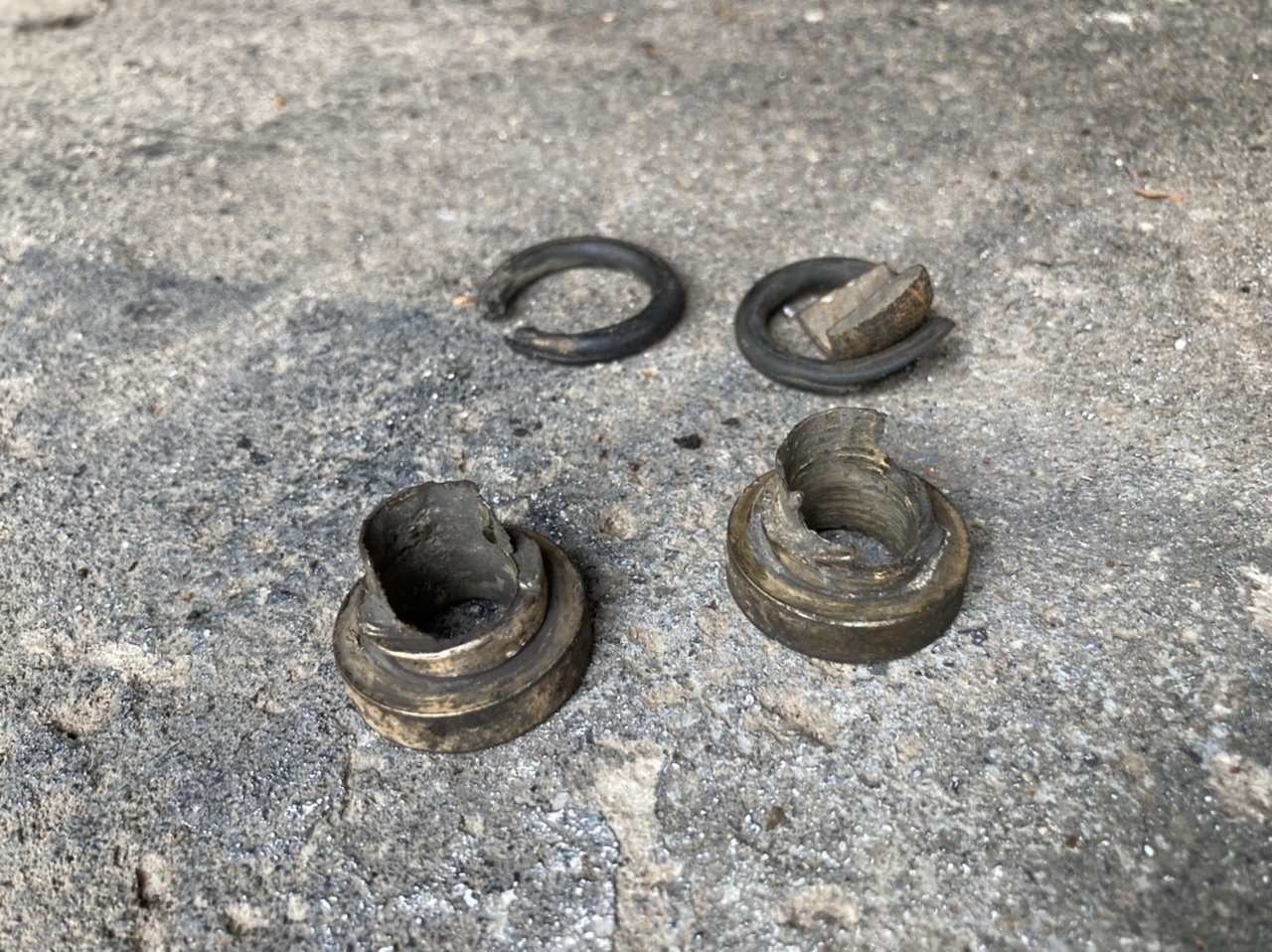

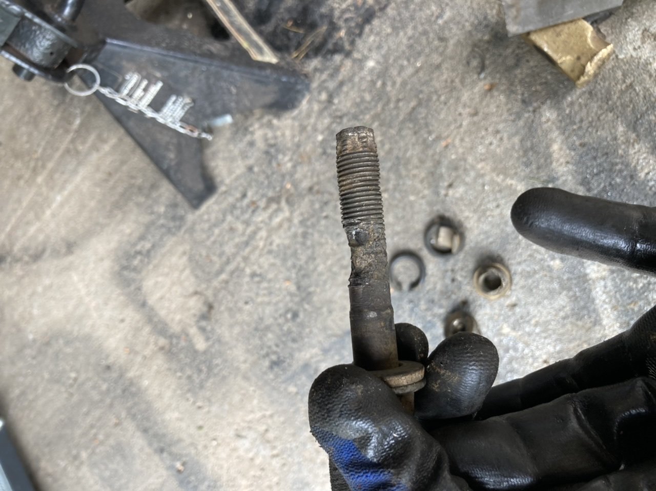

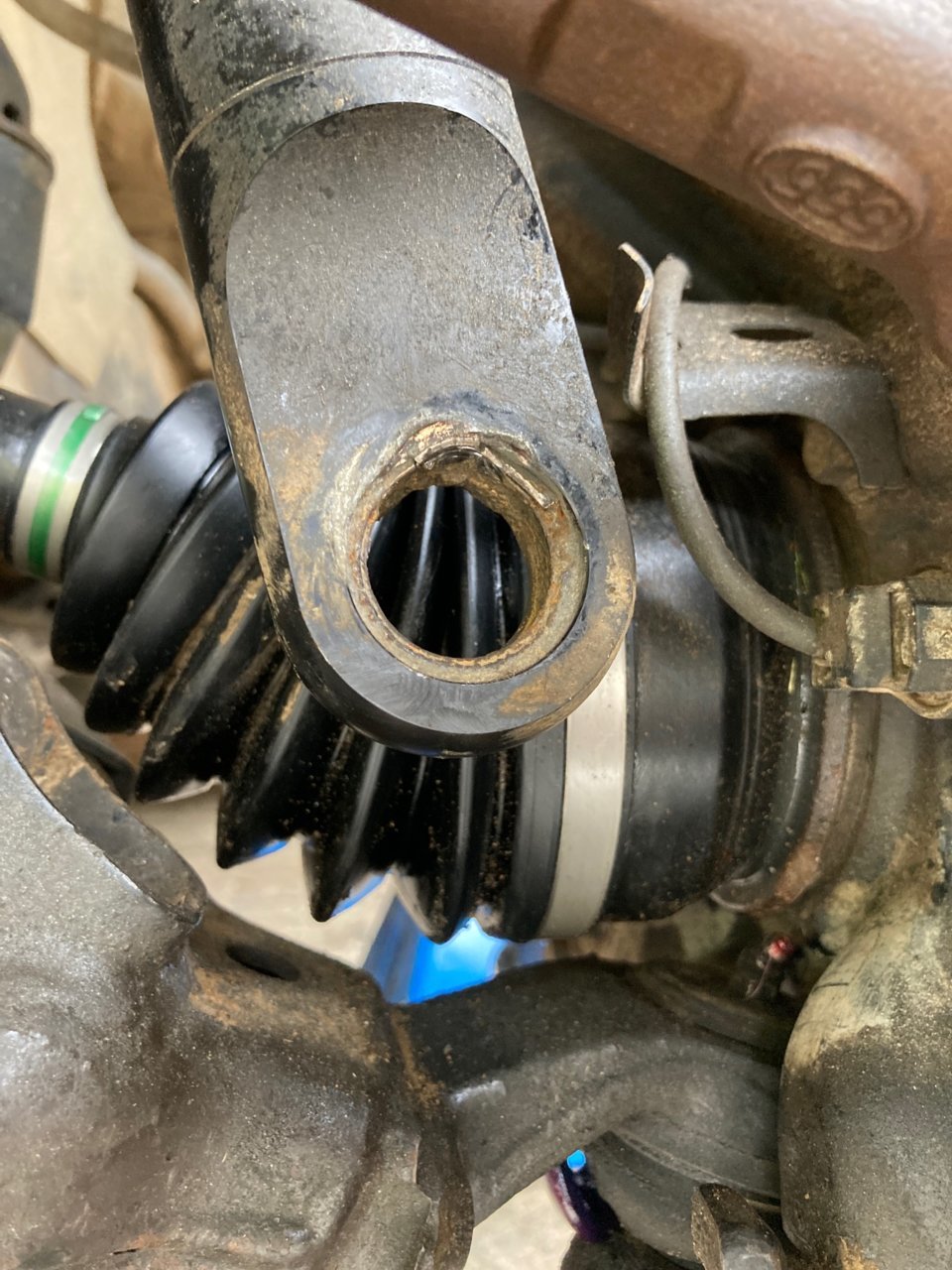

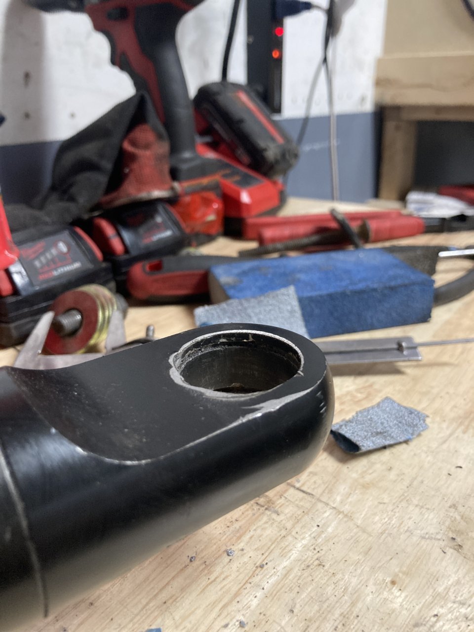

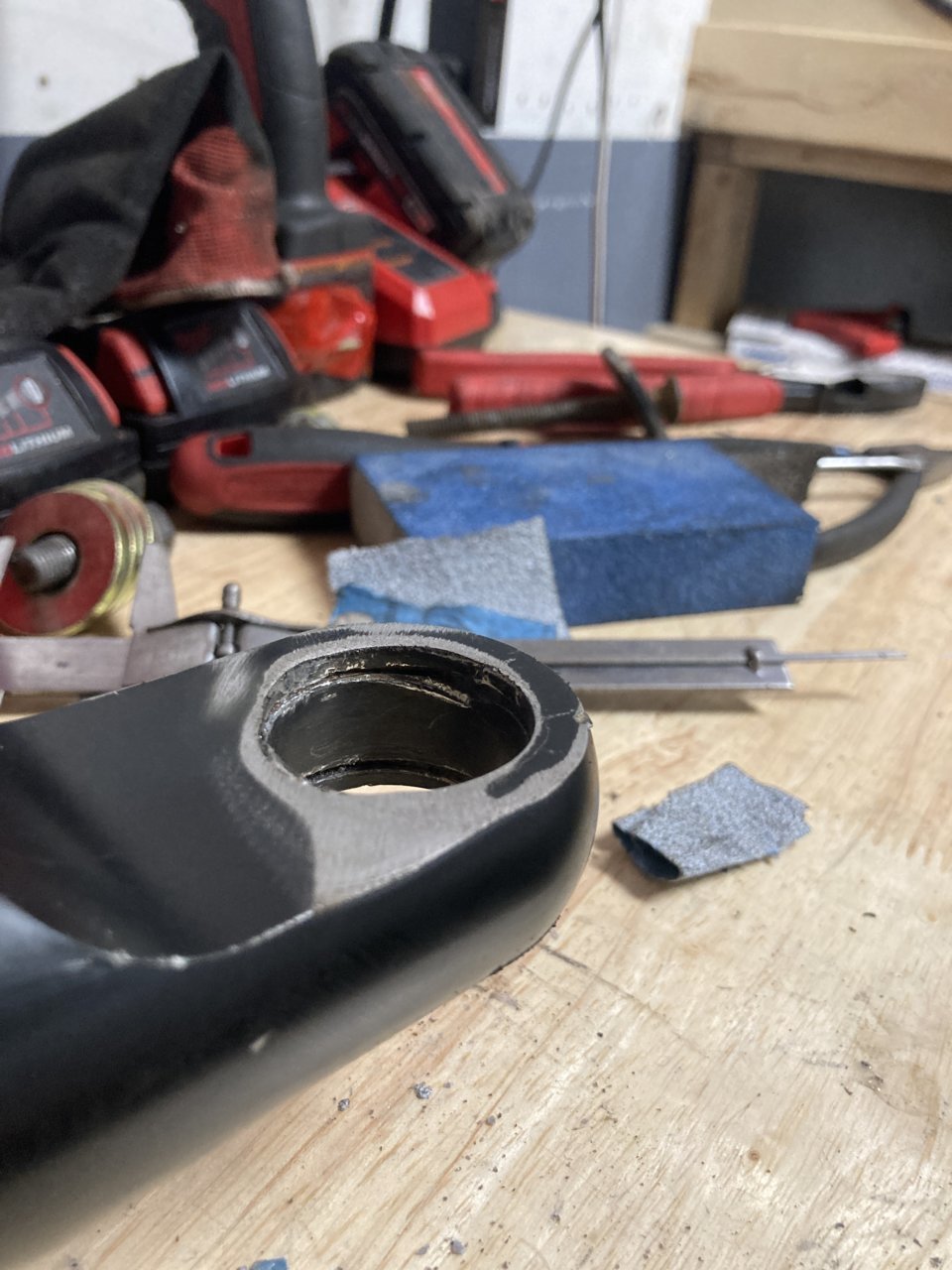

    I wouldn’t buy Elka now, they prioritize sales over service and refuse to service/repair per email they sent to customers/service departments. Called everyone who possibly can help, nobody can do anything now. Maybe when everything get's back to normal, but that's like another couple years at least.
    I am now stuck with junk that can’t be fixed or used after 2 years. :angrygirl:
    807BFF2C-356F-4578-903C-4E3E0D743990.jpg C991DC35-A557-4BDA-958E-388921B34D27.jpg 9ABE5B8F-9F8D-46FD-9299-A54BB3A286BF.jpg
    Update: taking in my hands and going to mix and match while they search for parts for me. Pressed out the bearing and cleaned up the piece, off to find the bearings and misalignment spacers.
    6A7D5063-36B0-447D-A7F2-236A868F2F10.jpg B11217AA-6684-44B9-A784-66A783A79174.jpg
    Update 2:
    Due to design changes between when I got mine and now, mine are now getting fully rebuild where shafts and lower eyelets are getting replaced. Getting it done with authorized Elka service facility. Good news it’s going to take couple weeks, bad news it’s a :spending: because out of warranty. Also do check your ball bearings at least once every 6 months!

    Those look like they knocked the hell out of themselves for quite some time to have that shock end deformed and the bolt half-eaten away. I'll make sure to check on that sucker and those bearings.

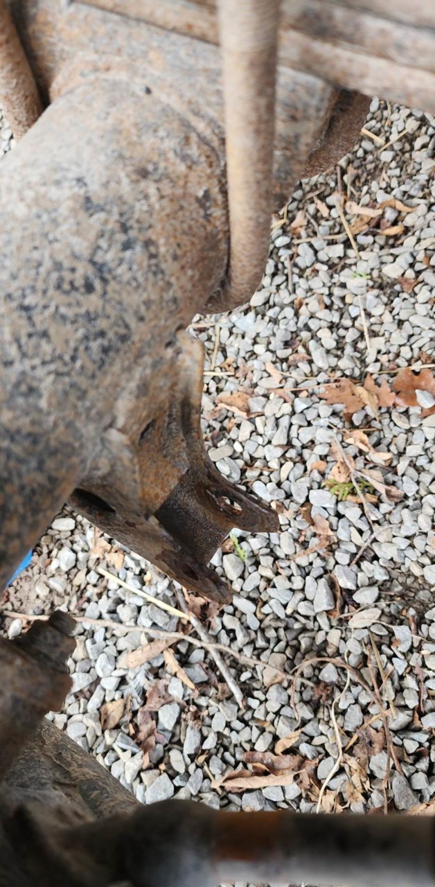

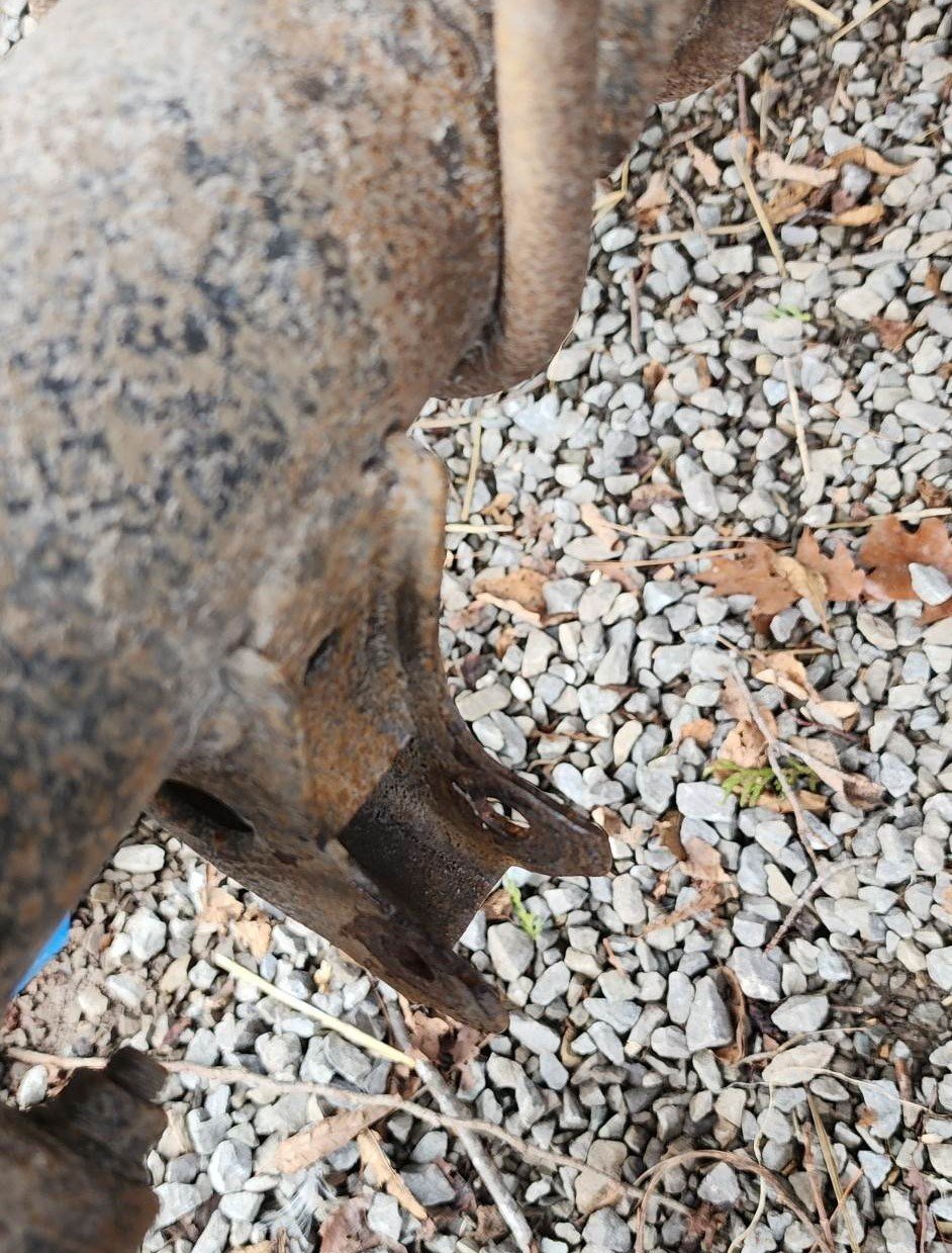

    It's entirely possible I'm in the wrong thread, but doing some research as I replace my rear shocks on my 2012 with the Elka 2.5s.
    Curious if anyone else has run into a spacing issue on the bottom rear shock mount? My Elka 2.5's are much wider than the stock seat and I've done a bit of bending with not luck yet getting them seated and don't want to over bend the steel. TIA

    Make sure they sent Tacoma shocks and not Tundra shocks?

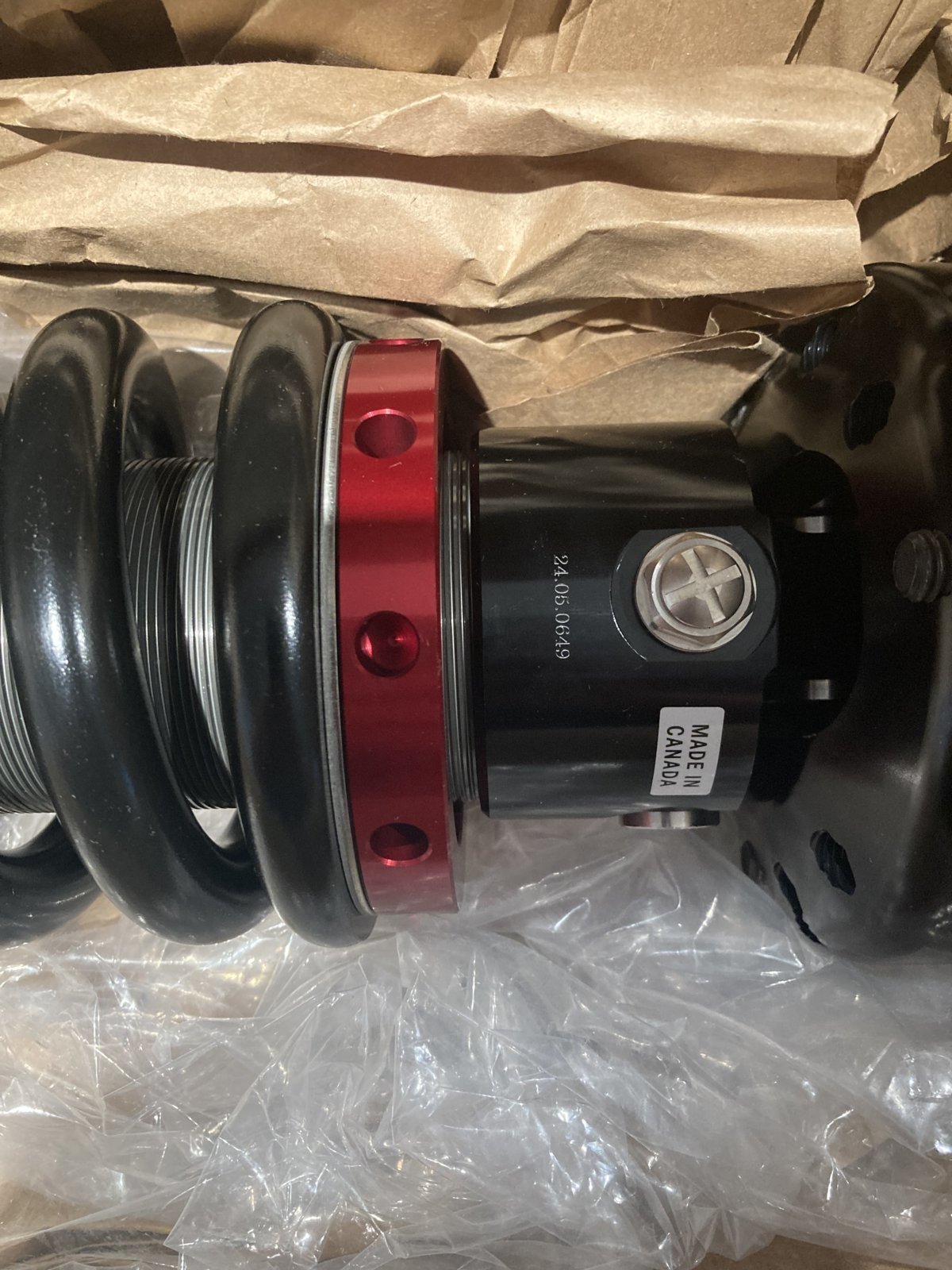

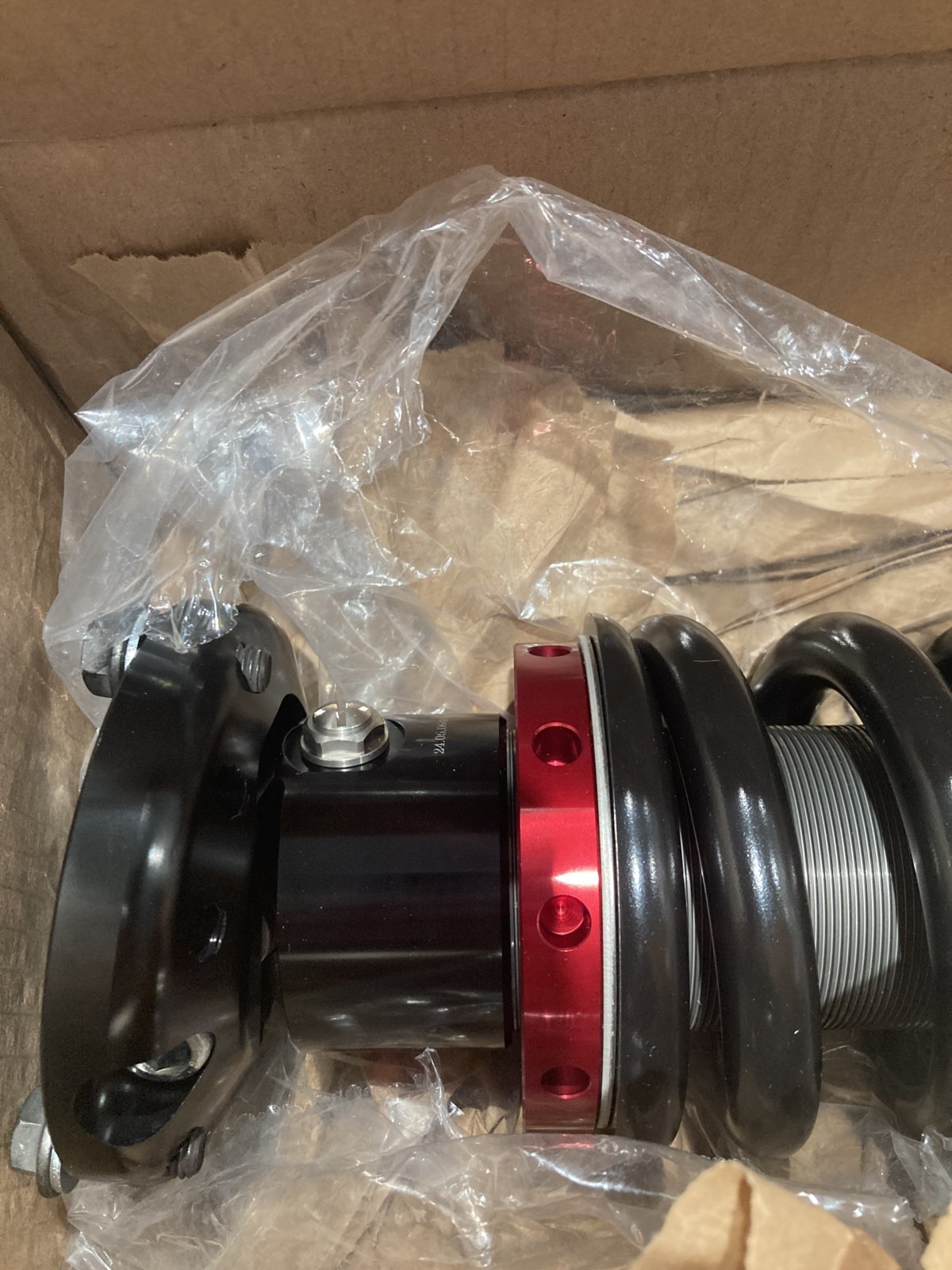

    Hello, received my 90714-14x700 coil overs these are the 2.5” body shock with 700# coils. Does this preload look right for the factory set 2.5” of lift? Every photo/post I’ve seen seems to show WAY more preload on the shocks, I know this could be coil choice and front end weight.

    I have 13" 700lb with about 1.25" of thread showing for 2.25" of lift. I guess measure from wheel center to top of fender before and after install and give it a shot.

    Yeah, just was wanting to avoid having to adjust the preload on truck. And odd your coils are only 13” and newer coils are 14”, yours must be older?

    Email Elka and confirm with them the height adjustment. They’re pretty spot on.

    I'm also running the 2.5/700lb combo. up front. The thread showing above the preload ring measures 11/16" from the factory on mine.
    It's sitting level with Deaver stage 3 leaf springs in the rear and laden for travel.
    Extremely please with the suspension, on and off highway.
