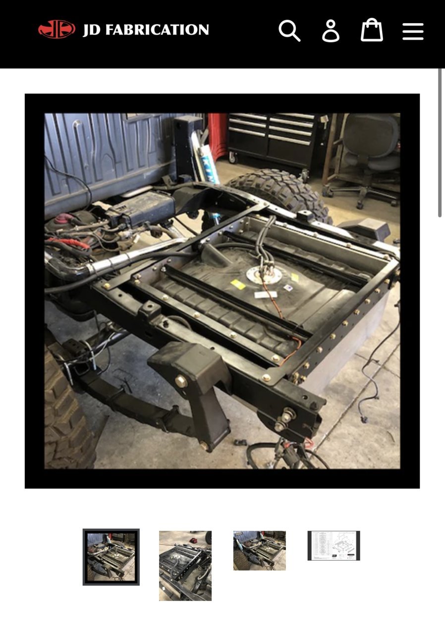

    this is nuts
    More fuel storage doesn’t worsen emissions
    why not get the JDFab one
    also cheaper

  19. Jul 26, 2023 at 11:51 AM
    #19
    JustAddMud
    JustAddMud Professional Grease Monkey
    Aug 20, 2012
    #85169
    1,707
    J
    Summerville SC
    12 4x4 TRD OR
    Yes
    Why not both and use the JDFab as the transfer tank? From the looks of the picture, the stock tank is still suspended in that photo. The LRA doesn't go past the rear axle and it looks like the JDFab doesn't go forward of the rear axle. I haven't researched it but it looks like it is a transfer tank.
    Edit: Yup, I just looked. It's an Aux tank. Just imagine, 34 Gal LRA tank and a 31 Gal fuel cell. 65 total Gal of fuel just might have to reclassify the truck as a tanker at that point. With my MPG, that's roughly 780 miles to empty. If you have a stock truck that's 1235 miles to empty. My spare tire doesn't fit under the bed anymore so maybe I just might look into that when it comes back on the market.
    -J
  20. Jul 26, 2023 at 11:57 AM
    #20
    HomerTaco
    Mar 28, 2010
    #34129
    45,874
    HomerTaco
    HomerTaco
    HomerTaco
    I just checked it out. Can be used as either primary or transfer.
    Neat option but also currently out of stock as per the website.
