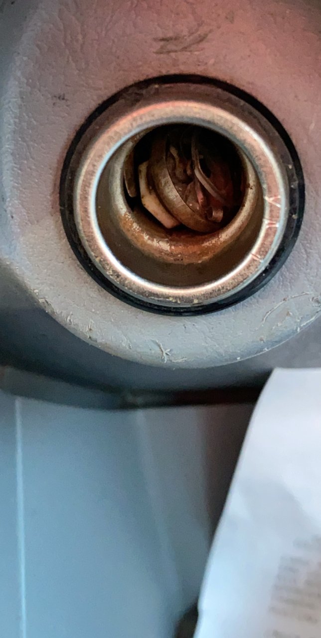

    the left one is fried and on my last post it said i need a whole new one, i guess the source or maybe the socket?

    i don’t know my part numbers ): i pulled on this and my left one stopped working , i changed the fuse but yet it doesn’t turn on

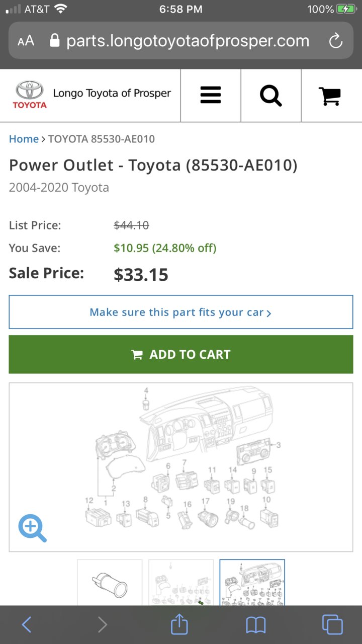

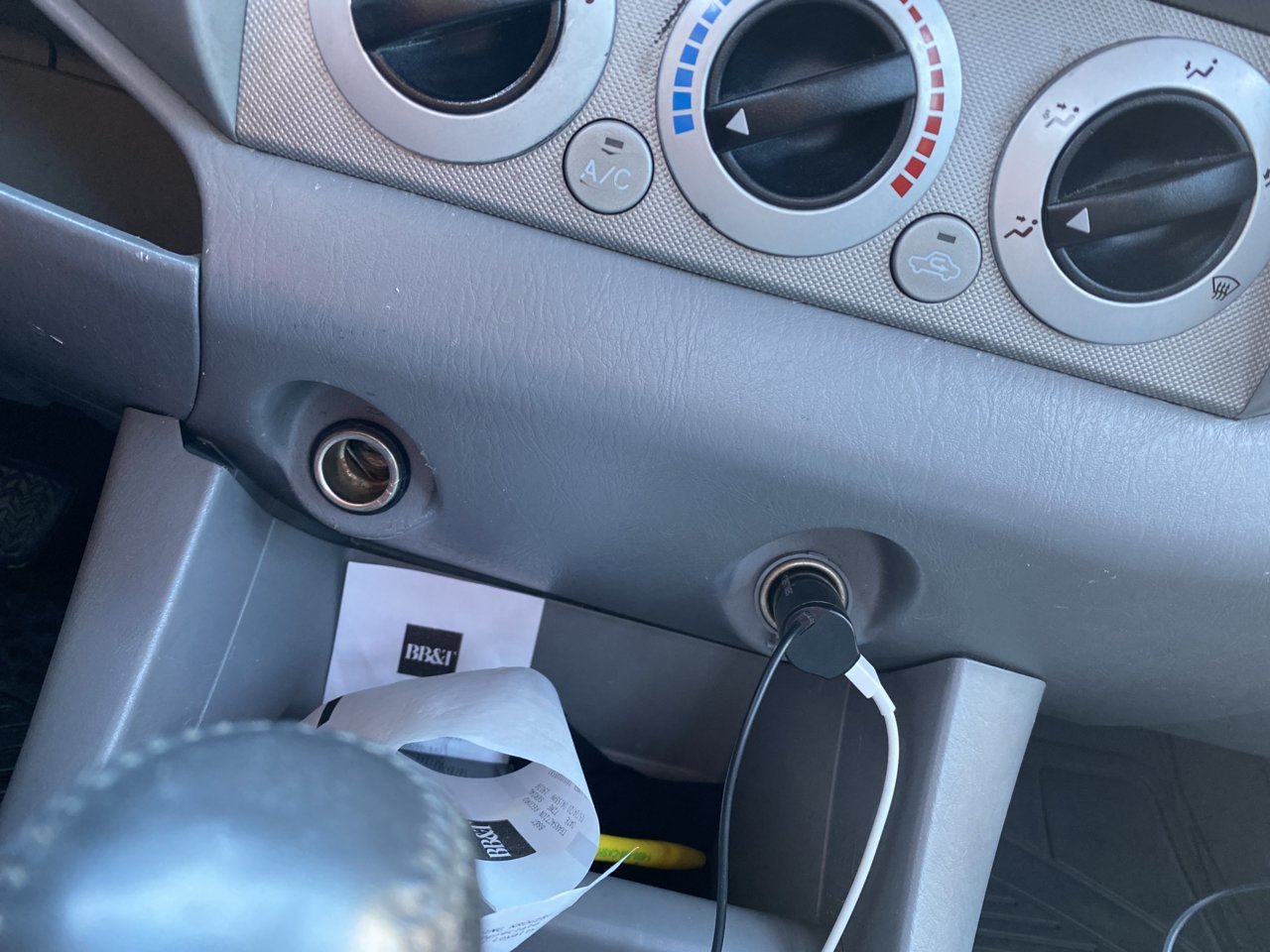

    On your ‘08, the left one is a cigarette lighter socket and the right one is a power outlet. The holes in the panel are different so you need 1 of each. Or, you could replace the panel with a ‘12-‘15 panel and end up with 4 switch holes and 2 power outlets. If you switch to the ‘09-‘11 panel, you end up with 3 switch holes, 1 cigarette lighter socket, and 1 power outlet. You can stick a cell phone charger in either, but you must have the correct sockets in whatever panel you have.
