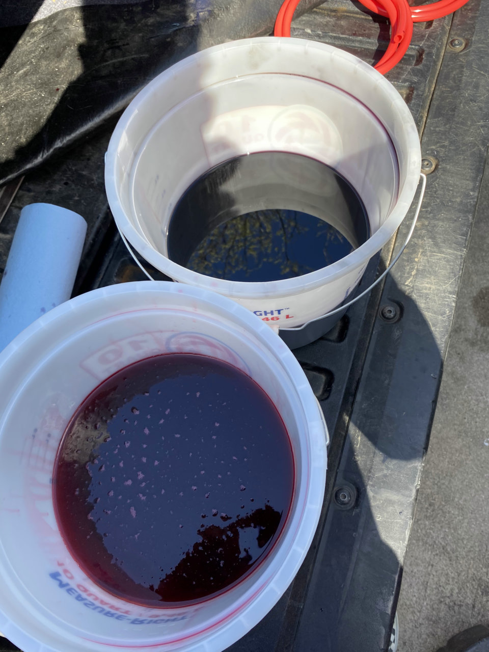

    I dropped the pan twice and the bottom looked pretty clean other than the normal amount of metal on the magnets nothing seemed unusual a bit dark but all WS fluid runs dark. The milage on the tacoma has 213,000 and im running a scan gauge for this reason to check the trans temp

    Below is what came out of the first drop left being new WS fluid and the other being what came out of the trans
