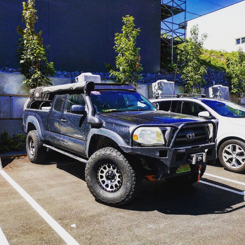

    Mat
    Abbotsford, BC, Canada
    09 Tacoma AC 2.7L 5spd 4x4
    Prinsu
    fatfurious2 likes this.

    Yes. this. how / what / where ?

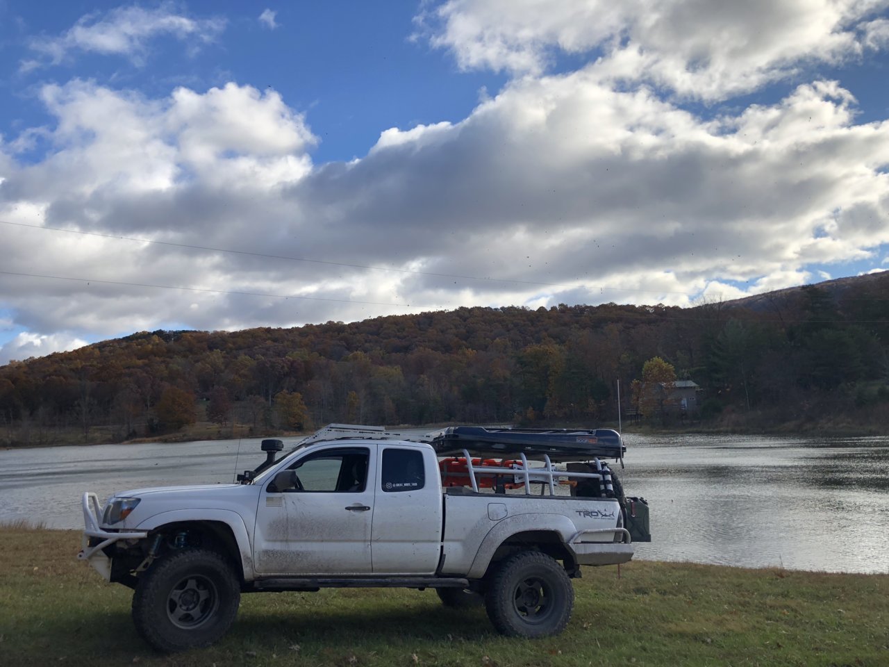

    You're going to have to drill holes in your roof
    But it looks damn good

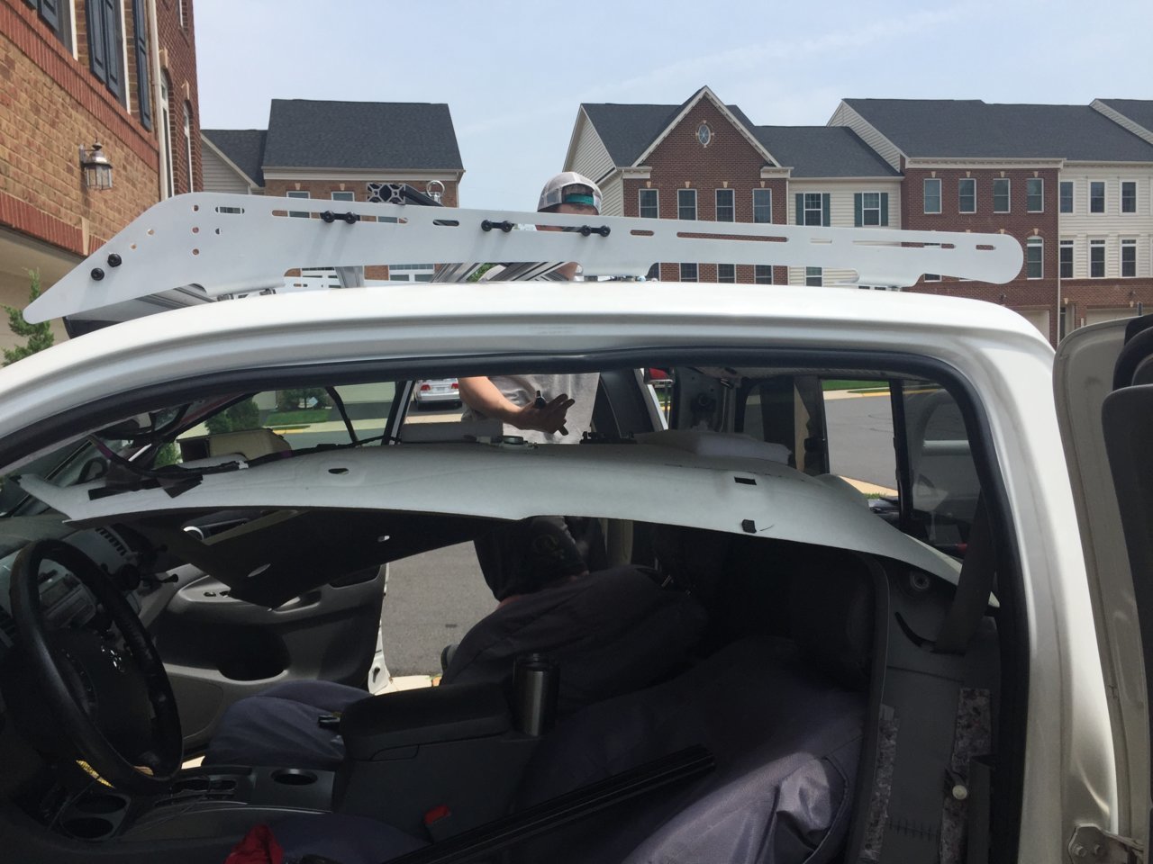

    You dropped your headliner eh... I just limited the bit so it didn't go to far in

    I have side curtain airbags. Didnt want to hit them

    Same here, I had issues with the airbag bracket at the rear of the roof nothing a punch and a hammer couldn't fix. Needed a smidge more room for the bolt

    Ohh. On the passenger side, I drilled the hole, but didn't put the rivnut. On driver side, just the rear rivnut is in. Didnt even bother with the hole. I don't think I tried to move the airbag

    I made a slight bend in the brackets to allow for the bolt to secure the rack properly, I also had to seal between the bolt and the spacer rain kept getting in
