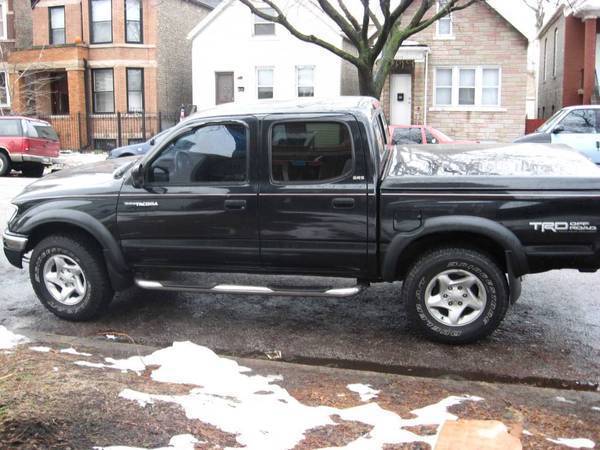

    i got the bilsteins 5100 on all four wheels the front set at 2.5 and a toytec AAL with a 1.5" block. sits very nicely, although ever since the lift I have had some problems with driveline vibration. I am sure it was there before but lifting it made it more noticeable. I am looking into getting some shims under the carrier bearing to remedy this.
    before
    after
