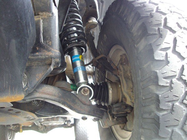

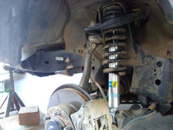

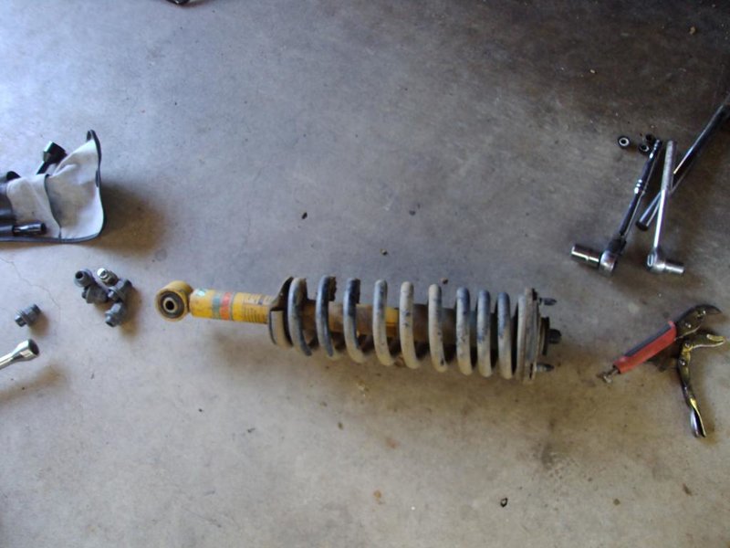

    You need a coil spring compressor, a few tools & a little mechanical apptitude, its a relatively easy but potentially deadly procedure if not done correctly (changing shocks ) If your changing the whole coil-over strut assembly,not so dangerous but you still need to support Truck w/stands under the frame & its best to have a floor jack under the lower control arm w/ a little pressure so the whole unit doesn't just drop & hang there when removing the coil.shock strut assembly, if your going to change shocks only then take note of the larger center nut I'm pointing at, loosen & back this nut off some but under NO CIRCUMSTANCE TAKE IT OFF UNTIL COIL SPRING IS SAFELY & CORRECTLY COMPRESSED !!! Failure to do this can be fatal !! That nut holds the preload of the coil-over assem. together & no, possible death is not an exaggeration, it is a fact & possible if careless. ( just common sense shit )........Good luck:cool::cool::D

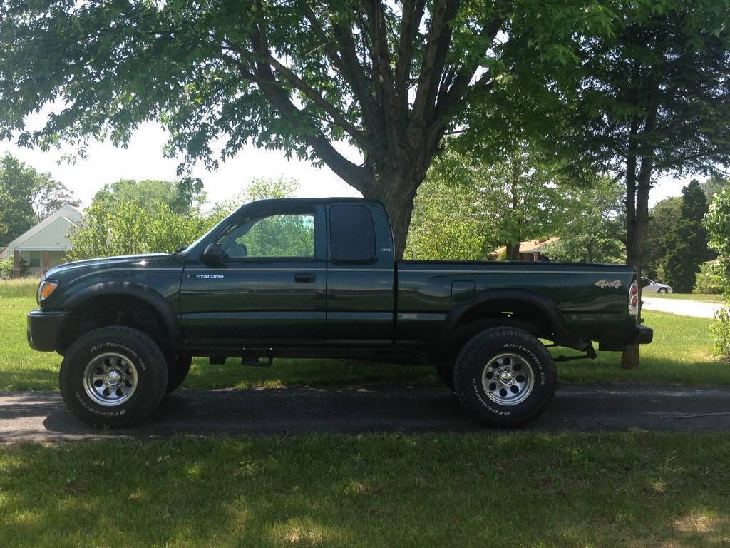

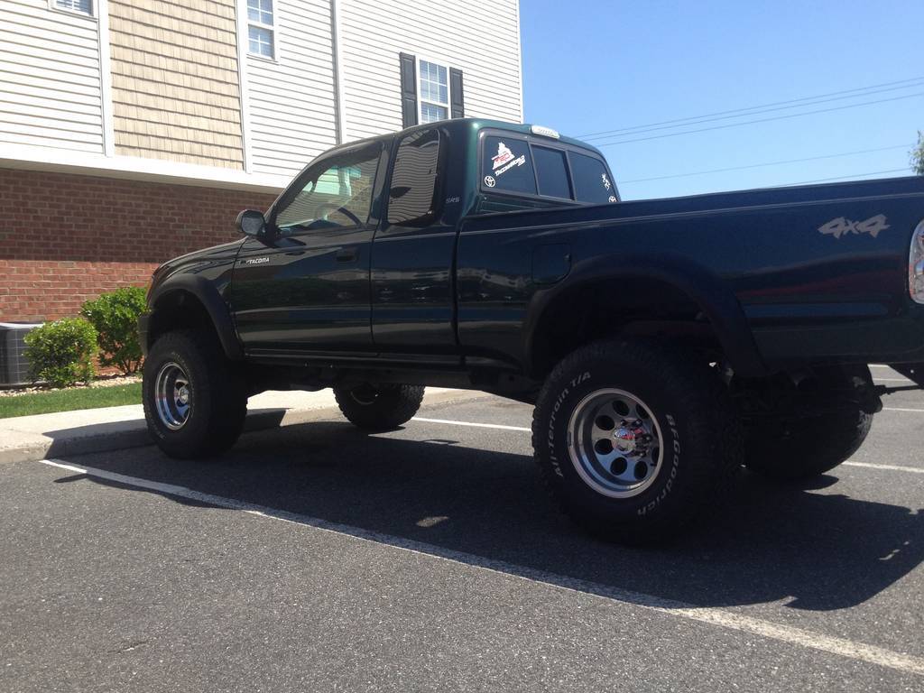

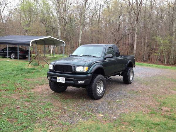

    I have mine lifted at 2.5 setting up front and all 5100's all around and gettin ready to add a 2" AAL in the rear need more positive for the leafs until
    I get a Dakar leaf pack.
    Before lift
    Before rear 5100's but with front done
    Both front and rear now just need AAL
