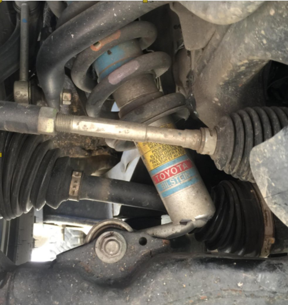

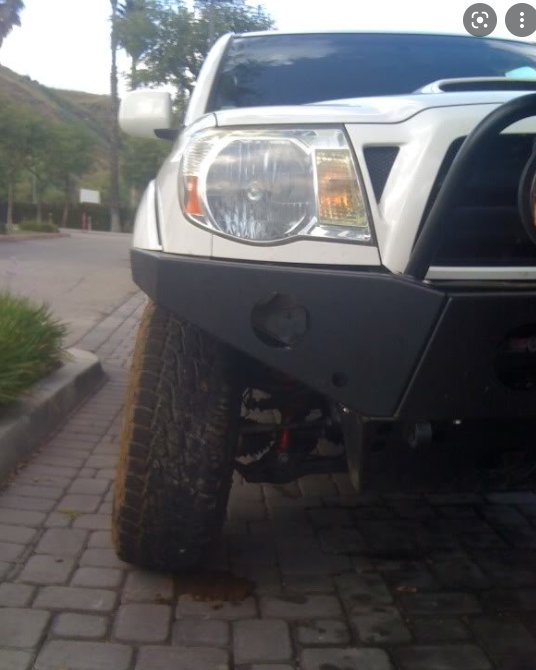

    Two most common problems to looks for :
    1. Bent lower rod end on your coil over :
    2. A bent spindle, if you have a bent spindle bad enough to affect a 2-3" height difference you would be able to see your tire actually leaning in like this :

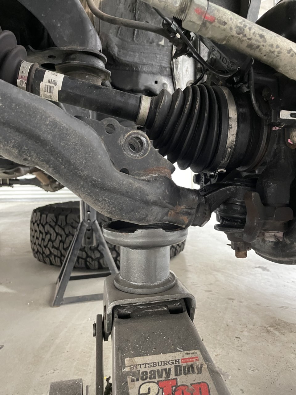

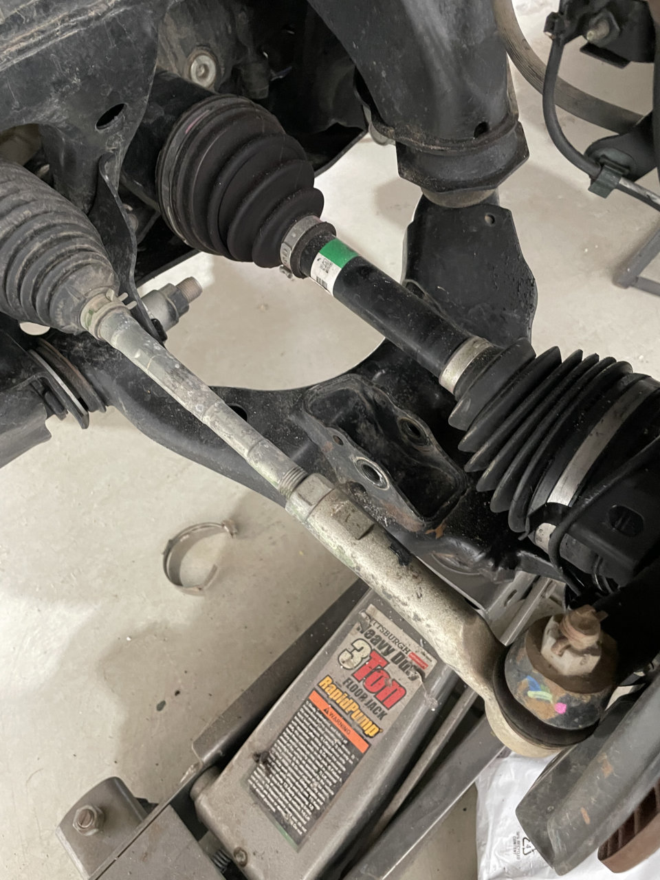

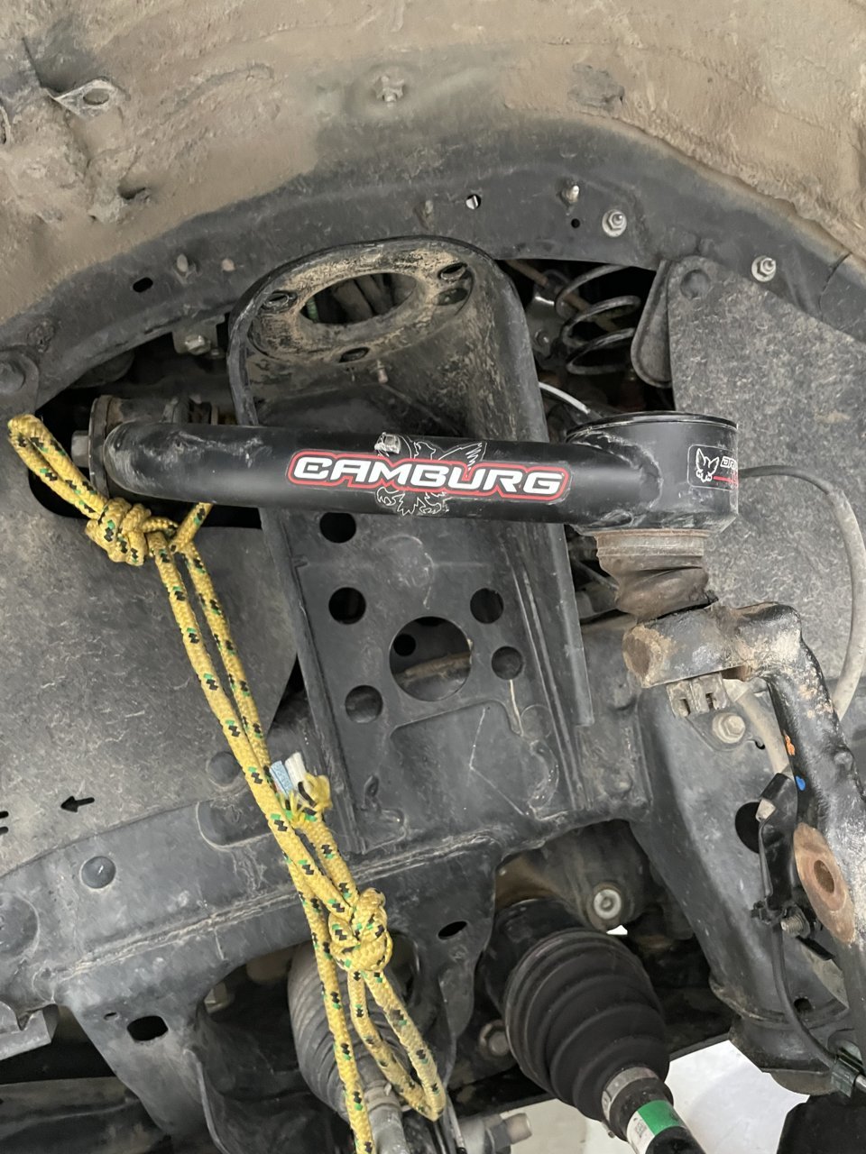

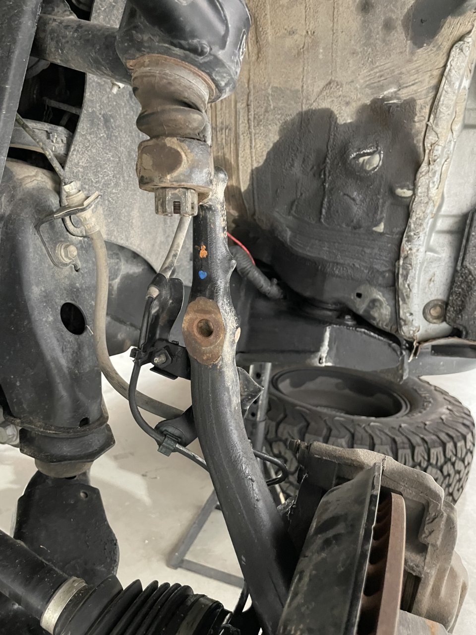

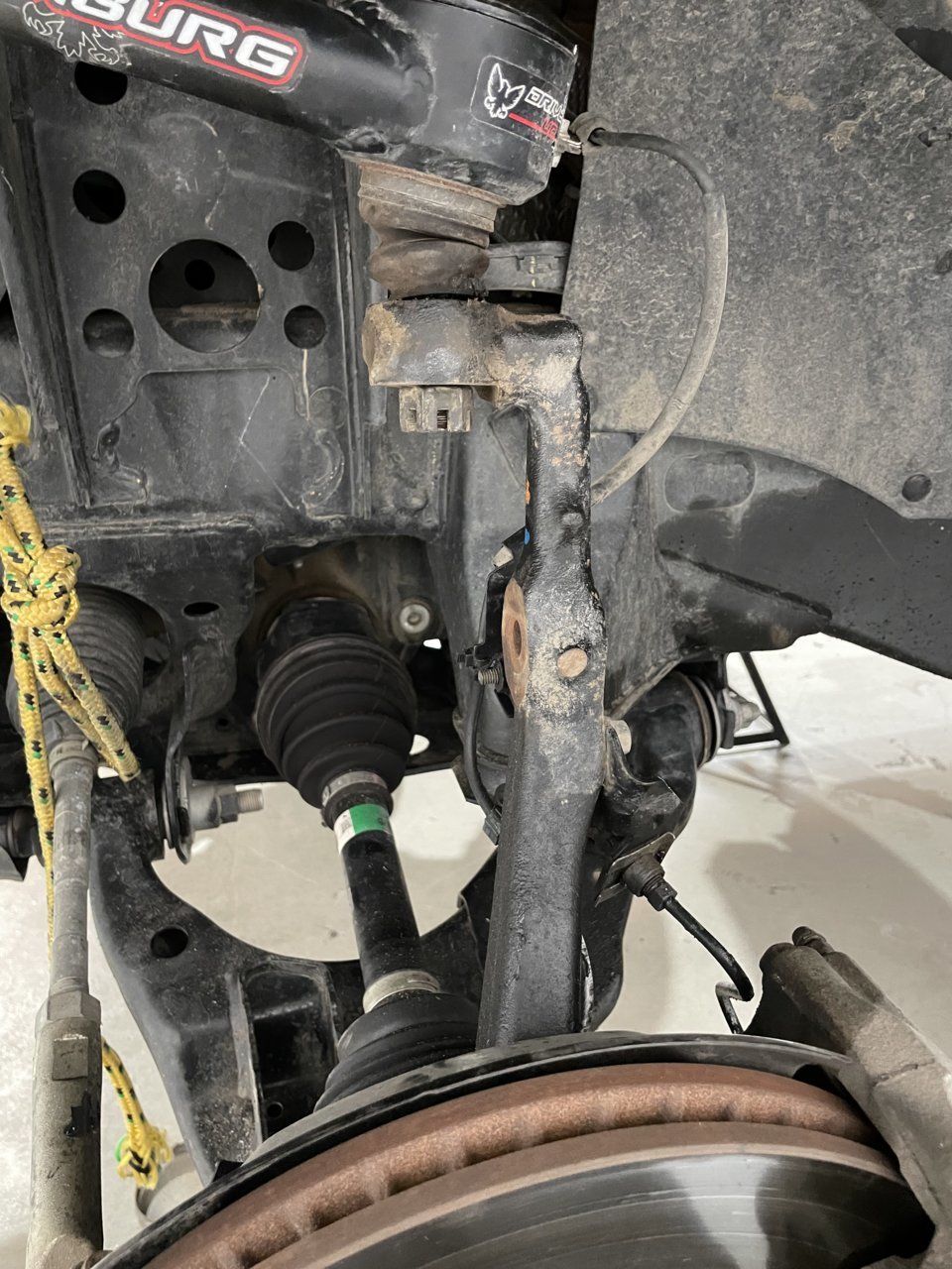

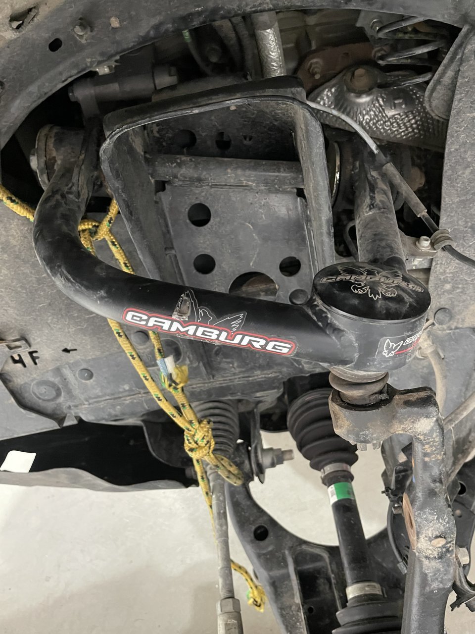

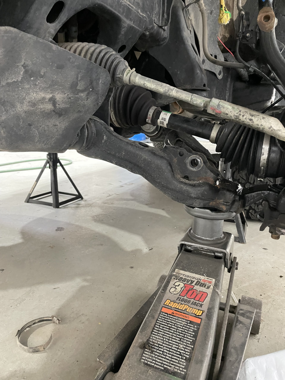

    i will send picks tomorrow but the shock looks fine on the outside just has a bouncy rebound and the tire looks straight not that tilted at all. some grease leaking from the uppers witch is wierd but doesn't look bent

    There’s all the pics I have of the components. Shock is getting rebuilt so once I get that I’ll put it together and send a pic of the lean if it’s not fixed. Which it probably won’t be! It’s a pretty substantial lean
