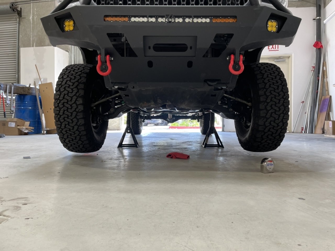

    Well you would be able to tell if the camber was off if the tire in the previous pictures were tilted inward or outwarbut they look pretty even to me

    Is your passenger side drooping farther than your driver side with all else the same? It looks like it in that picture, but it’s only a picture after all

    No, can't really tell from that 2D picture with the wheels off the ground. You said there was a lean so now I'm confused.

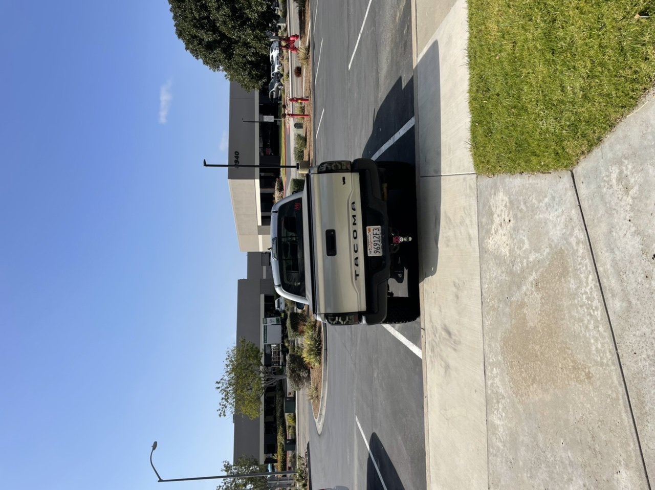

    Yes it is by 3/8th of an inch
    There’s a lean in the body as in the cab is leaning to one side like something is lower or bent on the driver side this isn’t an issue with my alignment I think the alignment is off from one side to the other because something else is fucked up i don’t thing being out of alignment would cause my body to droop 2 inches or more

    If you want to use pictures, take a shot from the front with the camera bumper level or a little higher and 1 from each side, composing the front half of the truck equally in both pictures at the same bumper level or a little higher. All on the ground as level as possible.
