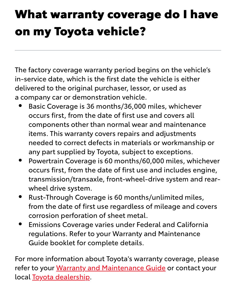

    Just curious, what was the mileage when you bought the truck?
    The manufacturer warranty does not end at 36 and 60,000, but 36 and 60,000+ the mileage at time of purchase.
    H1Unlimited16[OP] likes this.

    When I bought the truck the odometer was at 6 miles so still out of the 60k/5 year powertrain. Thanks for the idea though

    OK - not to double post back-to-back - but it is CLEAR the very first post in this thread was just updated with critical and meaningful information that should have been included in the first place.
    As a result, and nevertheless, my very candid comments:
    You pegged your engine temp gauge and had your Taco towed to a shop in Bellevue WA. That mechanic communicated the following:
    Your mechanic in Bellevue, WA needs to improve his/her communication skills. That isn't a whole lot of help unless you know how to interpret this message. Excessive hydrocarbons are present in the vehicle. Like where? The back seat? The glove box? This goes hand-in-hand with asking questions (see above). Anyway................
    Here's what that person almost undoubtedly managed to figure out. Your truck wouldn't start by the time it got to him/her. No Crank, No Start. It wouldn't even turn over. Checked the battery and blah blah blah. Then, they plugged in a scan tool and got a P0301 DTC. Then, they popped the hood and found coolant all over your engine and all around the #1 cylinder. Then, they performed a "block test" of the coolant fluid in the radiator and discovered hydrocarbons (unburnt exhaust gas) in the coolant. This test is super common and turns the test fluid from yellow to blue. That is a classic diagnostic of a blown head gasket which can fill the adjacent cylinder(s) with coolant.
    They might've tried to bar the engine over with a big wrench on the crank pulley as a confirmation of their diagnosis and were unable to do so. Thus, the statement your engine is hydro-locked. NO BUENO.
    I'm guessing your oil was also milky, dirty, and low on the dipstick although that is not stated.
    The mechanic could have removed the #1 spark plug, and been able to turn the engine over while it spit coolant out of the #1 spark plug hole. But didn't know to do so or bother to do so.
    His/her POV. You got a dead cylinder. #1. Blown head gasket. Haven't diagnosed the cause (failed water pump & subsequent overheating or straight up head gasket failure), but your best bet is to get this to Toyota where they have the expertise to confirm my diagnosis and get you back on the road. I do oil changes and brake pads and evap system leaks, but not Toyota engine overhauls / exhanges especially considering your warranty circumstances.
    THIS IS ASOLUTELY WHAT HAPPENED AT YOU MECHANIC IN BELLEVUE WA.
    Then, you had it towed to the dealership in Beaverton OR where you bought it from. And they confirmed the exact same thing. Failed water pump, failed cylinder head gasket, #1 cylinder dead and full of fluid, no bueno.
    Extended warranties are a complete and total rip-off IMHO for this case study in this thread right here. Every part is considered a "wearable" component meaning it is not covered. Obviously brake pads and tires and clutches bulbs and belts are wearable and not covered. However, I would've though Toyota would warranty their water pump to 100k miles, but I guess not. Check your policy.
    Here's where I get critical and candid. There is still absolutely a reason Toyota is denying your extended warranty claim. One, they are going by the book. Period, end of discussion. Too bad for you. Life is not fair, and then you die.
    Two, this type of engine failure does not just instantaneously happen. Not on a modern Toyota V6 IMHO. I'm going to suggest THERE WERE WARNING SIGNS IN ADVANCE and they were probably ignored.
    Toyota water pumps do not fail like this. They start leaking from the weep hole. They lose efficiency gradually. You get a Low Coolant Level warning light on the dash weeks, if not, months before a failure like this occurs.
    I'm going to call a spade a spade and challenge the statement you had no dash lights in advance. The Toyota TechStream software is WICKED good and can determine exactly how long ago DTCs were first illuminated even if cleared by someone previously.
    Even if the cylinder head gasket leak occurred first, and was causing coolant to leak into the #1 cylinder, you would've got a Check Engine Light and P0301 DTC misfire code weeks, if not months, before your #1 cylinder hydrolocked because the spark plug was getting wet & sprayed with coolant and not firing.
    With a V6 cylinder engine misfire, your engine would have been shaking and virbrating like mad for weeks, if not months, before this type of failure.
    I'm going to go out on a limb and also suggest the Toyota dealer drained your oil and found about 3 quarts of black sludge. And an oil filter cartridge full of metal shavings and particles. None of which happens in the few moments your coolant temp pegs out and you immediately pull over like a saint. This is additional evidence the dealer will use against you.
    You can agree or disagree, but when it comes to benevolent dealership support, these factors make a difference.
    Has your Taco been serviced by the dealer? Or there is zero record of such? Are the tires bald, the brake pads squealing, and the interior filthy?
