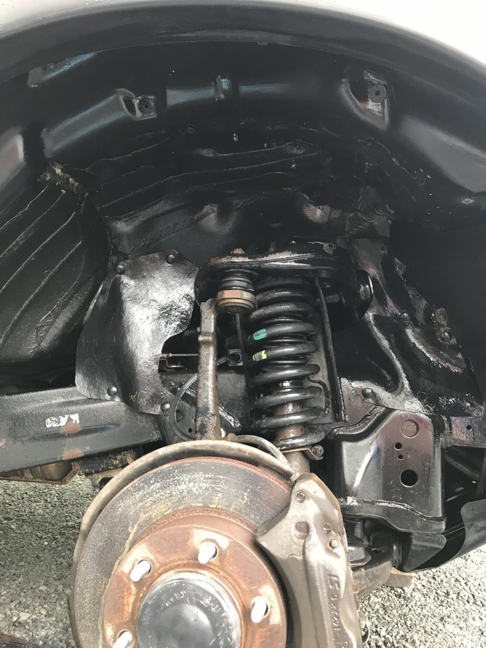

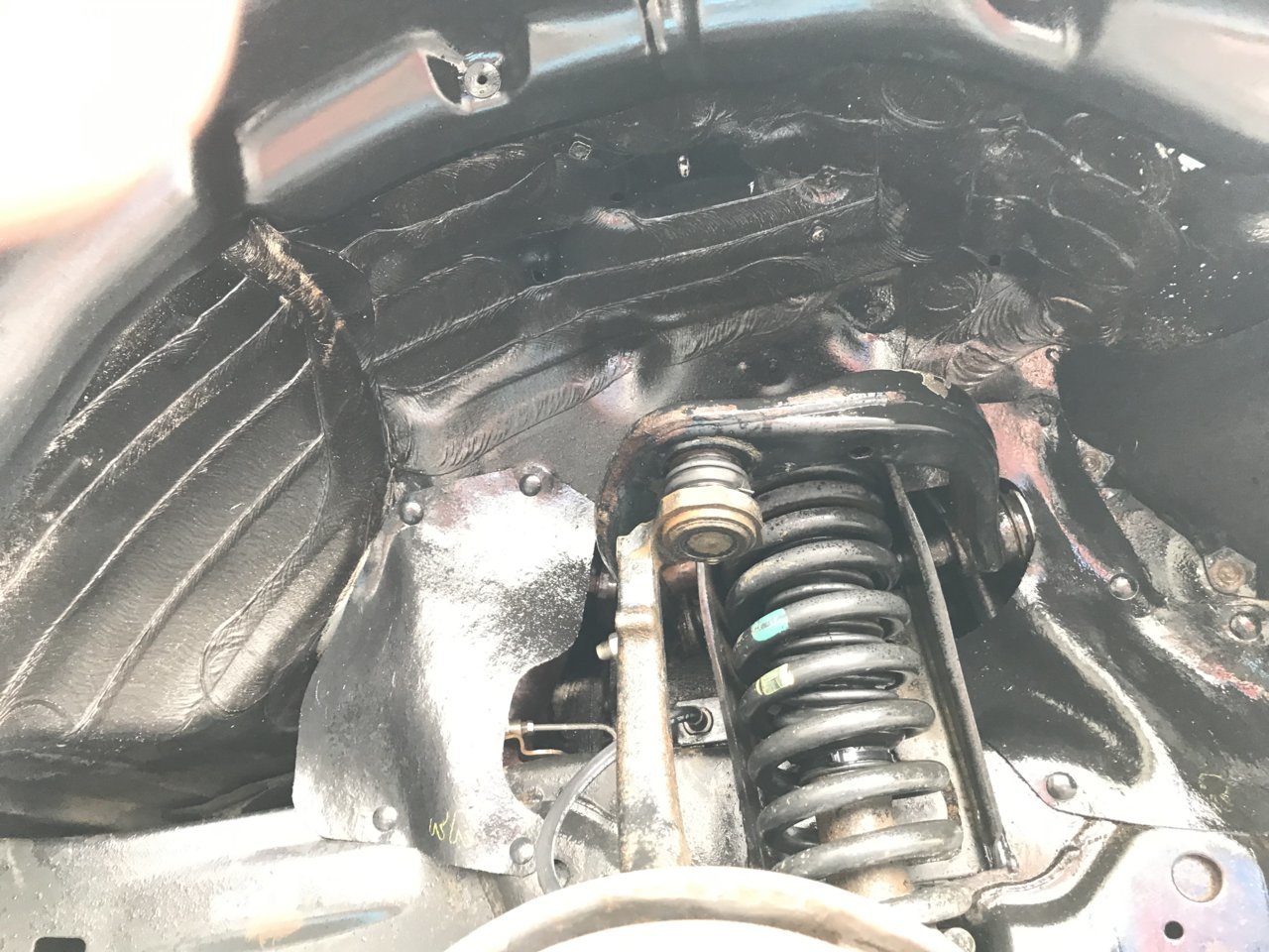

    Recently I’ve been looking into purchasing a set of 0-2 lift for my 2002 Toyota Tacoma, and am really considering the Bilstein 5100, the front shocks are 0-2inch lift and a 1inch lift for the rear. So my two question were would 2 inches be enough on the front end for the 2018 Tacoma Offroad wheels with 265 75 16 tires falken wildpeaks? And my other question is I believe the previous owner purchased a set of quick struts, but I’m not 100% sure if that is the case. Would some one be able to chime in and tell me if the springs are the factory ones, my truck is a trd so I believe it have different springs than the standard 4x4.

    Springs for a 4x4 and TRD would be the same; I threw my factory suspension away so I can't tell you if your springs are stock or not though.
    Depending on the mileage of your vehicle and springs, I'd opt to just replace the springs.
