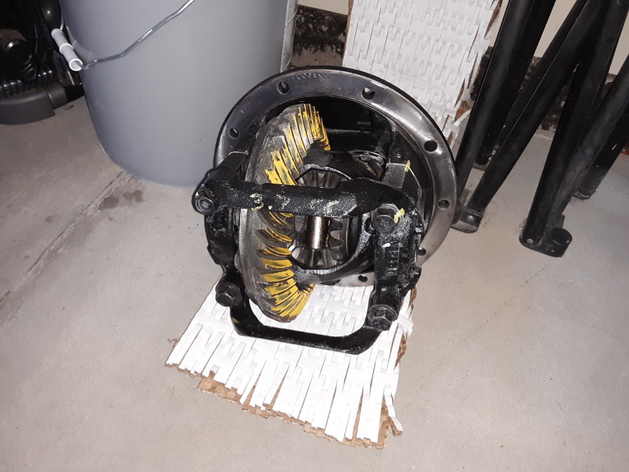

    finally a major issue (2 actually) arose after 300k miles
    In dec (2018) I started to notice a strange noise (some what like an exhaust leak) while decelerating from 60mph down to 40mph.
    After research & checking my truck I found a very sloppy connection where the front cv axle met the front diff (on drivers side). Found a worn factory needle bearing (carrier bearing) located inside the front diff. In trying to find/solve this issue, I also ended up replacing both front wheel bearings (which were fine, btw). Now I had become overly concerned about noises from under the truck, & noticed another strange noise. I was hearing a howling sound when decelerating between 50-70mph, most audible/noticable/demonstratable at 60mph. This sound was coming from the rear of the truck. I again ended up changing both rear wheel bearing in an attempt to resolve the howl, but the howl persisted. I created a thread about this howl-
    https://www.tacomaworld.com/threads/rear-end-howl-whine-at-60mph-no-more-howl-issue-solved.597315/
    the howl was a worn pinion bearing/race
    in a nutshell, I replaced all 4 wheel bearing, the needle bearing (replaced with ECGS bushing), & replaced the rear diff (aka 3rd member) with a rebuilt unit from ECGS (love those guys!) with with solid spacer instead of the crush spacer.
    my unicorn has been down graded to standard horse, lol

    replacement 3rd member from ECGS....installed yesterday & no more howl
