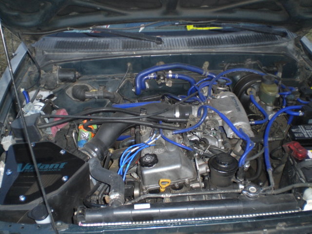

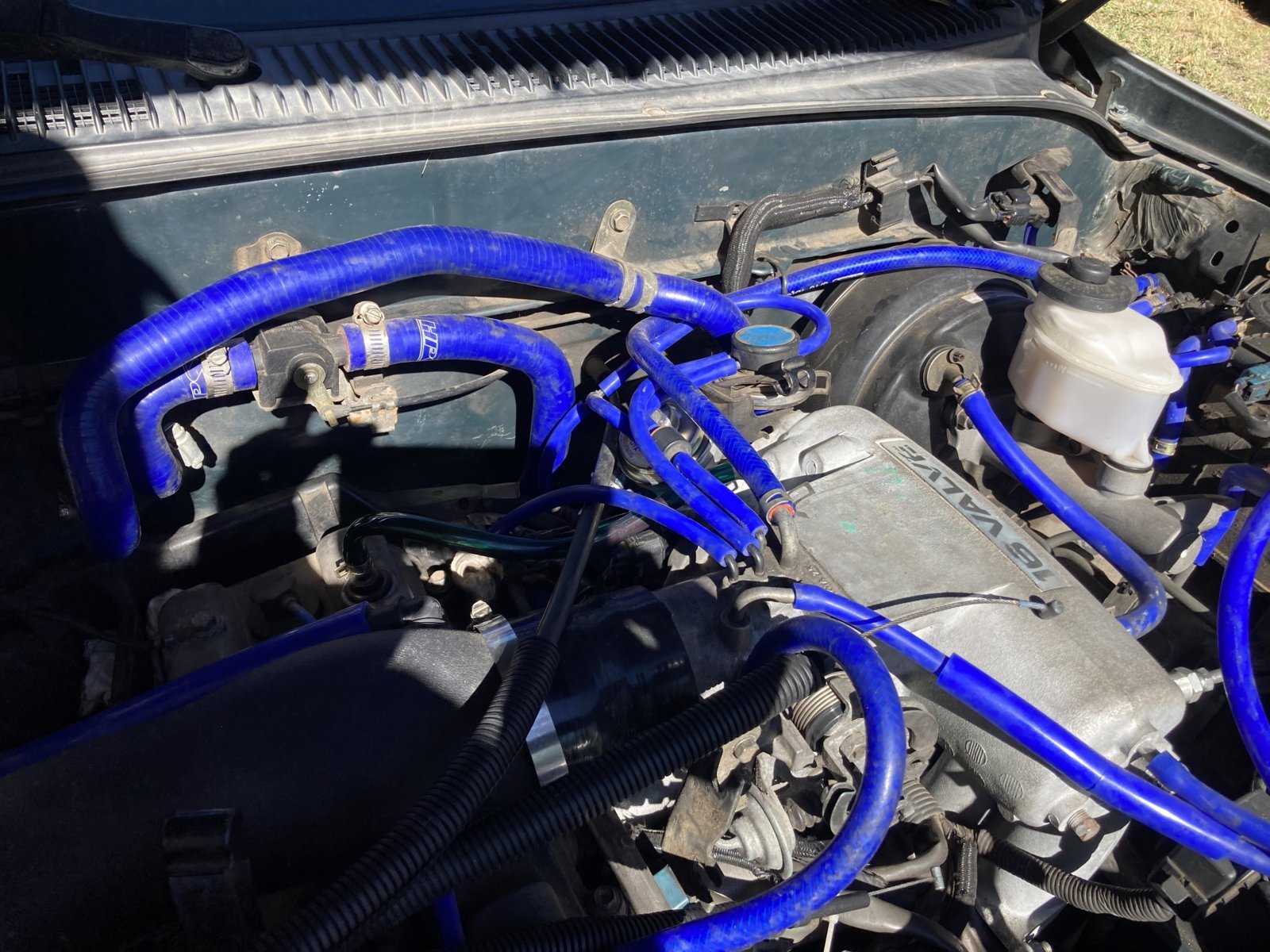

    Yeah I'm having exact same problem......but 4 banger world.....I have a 98 2.7/2.4 auto...
    Just randomly wont start......use to be after sitting for an hour...
    Then just today it sit for 4 hours and would just crank ....no start...
    Everything on the truck is less than 3 yrs old.........motor and block just hit 19K....
    All new sensors /coils/ injectors, maf, ect, iac, cam / clank sensor, ....new O2's
    All new headers, cat, walker exhaust...
    everything is new oem where posible........except its got its original neutral safety switch.....this is an auto a43D...
    All new silicone vac hoses......on everything..
    couple years no problems then couple weeks ago this all started
    Ive done new plugs, new maf, battery clean and scan good...
    I get no codes........I have -5 LTF trim at idle/ +10 at cruise....
    Cold air intake w outside air feed....no cel's
    Use to be messing with bat cables I could get running again..
    but really justs letting it set until it wants to fire up......hour or two later...
    when it do start....no cough or stuggle.....just fires right up, like you flipped a switch.
    Last time I jiggle the ecm connectors to get to fire up.......but who knows next time...do I have something going out...
    I have a spare everything so I can try anything...
    even a spare ecm......
    everything is new on the truck.....even all the fluids and hoses.....
    even my grounds are heavy duty and over kill....
    coils are year old denso's....
    fuel pump is 1 yr old denso.
    starter is 2 yrs old....
    When I test crank with a hose off the fuel reg....it comes pouring out...
    so its not pump or its circuit thats suspect.....
    Could the egr valve be stuck open?,,,,,,,at different times
    Only real guess I have left is swap out ecm......
    or maybe when the new motor was put in the crank sensor somehow got damaged.........I actually have a brandnew denso one in the bag....
    but it is a super PIA to pull that alt bracket off to get to that on the block....
    half day job on a hail marry guess....
    ........but I'm essentially beached right now....

    You would probably get better assistance in the forum for 1998 Tacoma's... This is a Second Generation Forum.
  7. Mar 30, 2024 at 5:55 PM

    Post in the 1st gen, as there's quite a bit of differences. In the mean time, you didn't say if you checked fuel pressure.
