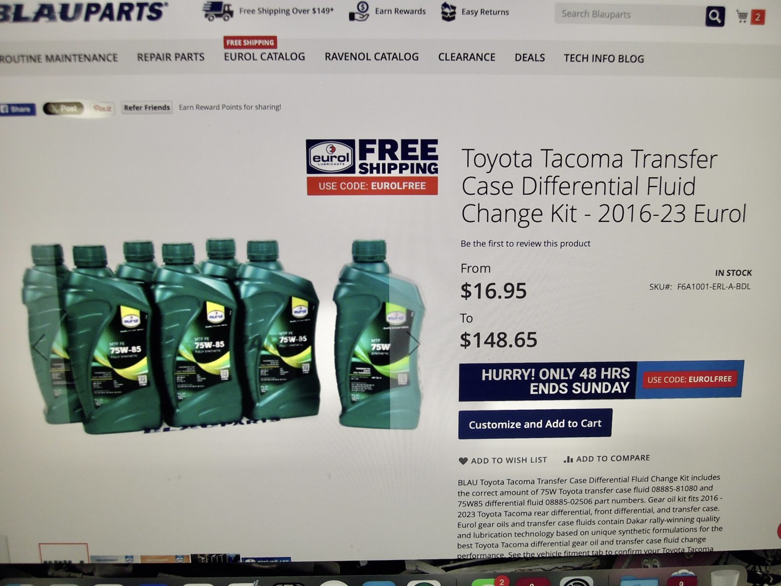

    Just be careful
    For the two rear ends you are good with this . Even though this says ok for the transfer , look into it for that . Because the gears are brass most Diff fluid can deteriorate the gears over time . Also don’t feel like you need 75W -85 . You can run 75W -90 gear oil
    I run Amsoil Severe gear oil in that weight . They come in nice squeeze pouches and are very easy to work with .
    Just remember a few things
    Buy new crush washers
    Open the fill plug before the drain plug
    The front diff can be a pain, make sure the Allen key socket fits perfect , this drain plug has a tendency to be very tight and strip easy. Spray the outside with a rust bust type stuff the night before .The transfer case you really should use the Toyota stuff or the Ravenol fluid . I think maybe redline has a compatible fluid also

    use the ravenol brand kit, from the same place, Blauparts. I did that this summer. Ski

    Thank-you sir. It is rare that I use the 4 wheel drive and will take your kind advice for the transfer case.
