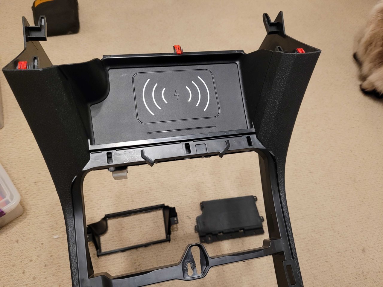

    My feedback after using it, I don't regret doing the install, it's definitely better than the OEM Qi charging pad, but it's not exactly incredible either. It's pretty finicky with placement of the phone and the light, while informative, ends up being a bit distracting (is the phone properly charging?) when it would be nice if we could just toss the damn phone in the spot and have it all "work".
    So, I wouldn't really say this is a home run yet. I know wireless charging pads are finicky beasts but I do wish there were some more help with self centering, perhaps by a series of steps in the tray or something, dunno, hard to have things work properly for all sizes of phones.
    Just my 2 cents.

    Don't get me wrong though, I don't regret doing it. The Qi pad is garbage and this one is better. There's no debating that point. It's just not yet perfect. Fit and finish are darn good though and charging power is better.

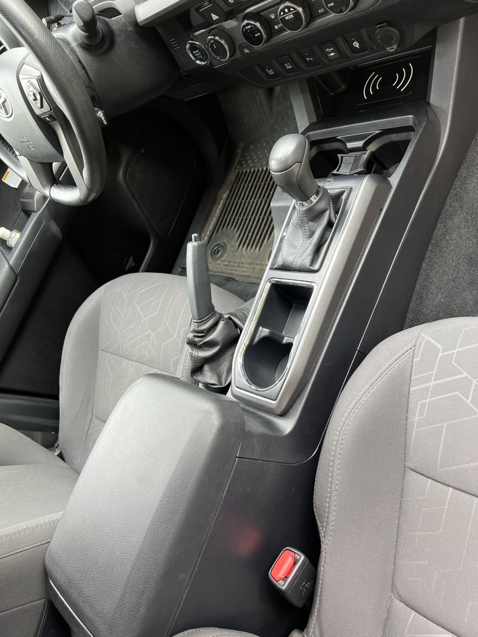

    Thank you. Finally got around to installing the XiPoo yesterday. Works as described on my iPhone 13 Pro. The stock QI would not charge it while in the case.

    personally, I think it fits well and looks great. The new charger does not have a clip in the center back as does the OEM, so it’s slightly less rigid. The mat is also slightly less non-slip, but doesn’t seem to be a problem with my case. It is also more black versus gray.

    You can swap the top portions of the OEM and aftermarket one. Some of the aftermarket screws are larger so I used the OEM screws for the four main screws that hold it together and the two after market screws on the two in the back.

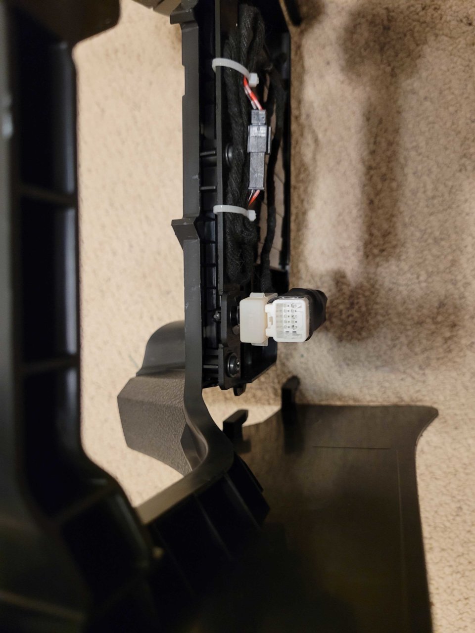

    This thread has some schematics and plug part numbers. The service manually also has an informative section. I ended up using a small relay to control the acc pin off of the switch pin and used portions of the aftermarket harness to keep the additional fuse and two pin connector. I didn't attempt to duplicate any of the smart key logic and only needed pins 1,3, and 5. Stole the harness clip from the OEM charger and the fuse and connector stacked nicely.

    Sometimes charging overheats the phone and it will disconnect AA and bluetooth when this happens. I was hoping the "better" charger wouldn't cause this, or cause it less frequently than factory, but it appears this is not the case (for my phone/case setup at least). I wanted to be able to turn the charger on and off like factory in the event I didn't need to charge the phone or I was storing metal items in the charging area.
    As far as what I did, I added a 12v relay and used the factory switch to control the relay. The linked thread has all the details for doing this, I don't want to provide a step by step for people that don't understand the risks or the how/why of how this works.
