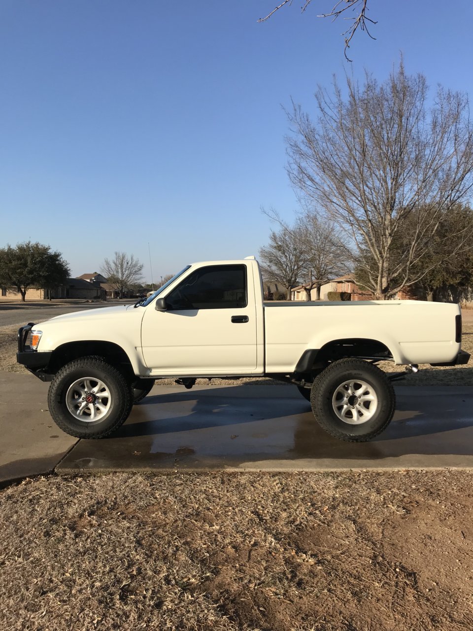

    I have a 94 Toyota Pickup that will not pass inspection. I’ve spent lots of money on the rebuild and need to find a Toy tech in Phoenix that will get it on the road again. Failed emissions test. Running rich on fuel and sounds like a diesel (knock in cylinder closest to cab , I think)
