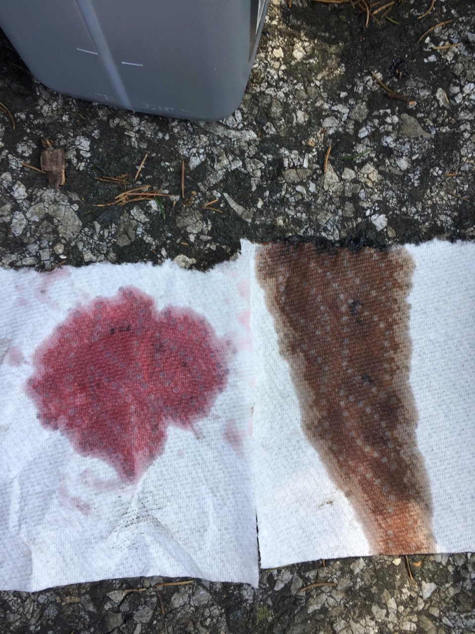

    I did a full flush at 125k. No regrets. Dropped the pan and changed the filter and cleaned the magnets also.

    This. I look at the transmission fluid Change interval from a broad perspective. Toyota has been progressively revising the interval since 2005... With that in mind I chose to apply the most stringent current recommendation (60k). I do a lot of off-road work so there is no reason not to. Most fluids in a vehicle should be changed periodically. Power steering, brake, coolant, engine oil, transmission oil, diff oil, all of it should be changed periodically.
    So many folks here are slaves to a 5k oil change (with a synthetic no less!) and the turn around and say “transmission! Hell just leave that stuff in there for 300k!”

    I was just quoted by a local Toyota dealership $260 bucks for a "flush" which I verified as being a true flush and not a multiple drain/refill. Seems steep and I'll get another quote from a different dealership, but I'll fall on the sword if I have to.

    I had two guys I trust tell me to leave it alone and two I trust more tell me they were idiots. I dont know what my truck has been through- drove ok but felt a little notchy going from 2 to 1 at low low speeds. I drained and filled. Manual trans 2006 with 137k and no records (according to toyota owners site and non of the paper records I received stating it had been done). Driven a couple hundred miles and it feels smoother to me, but I'm not that finely calibrated either...:rofl:

    I'm getting some weird feedback from my truck lately. Just got u joints, wheel bearings and now ring/pinion replaced. I'm having my mechanic flush the radiator, front diff and transmission as long as he has the truck, it's at just over 100k. I just heard back that the gear ratio that they took off the truck was slightly different than what the VIN suggested it should be and that the tranny fluid looked pretty dirty. I don't know wtf is going on with this truck, I rarely use it for actual truck purposes, had both diff oil changed at around 80k, and never got any indication that the transmission was in want of service.
