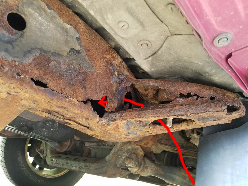

    THAT is a great picture, and demonstrates *exactly* where this frame's weakness lies.
    I drew a red arrow on this one to show the path of the salty crap that flies off the wheel and murders the frame;
    There are precisely TWO things that they SHOULD do to make this problem... not a problem.
    1) Get rid of that stupid hole in the frame rail at the back of the body mount.
    2) Add a rubber cap over the body mount access hole.
    If those two things (and ONLY those two things) were done, then these frames would last "long enough".
