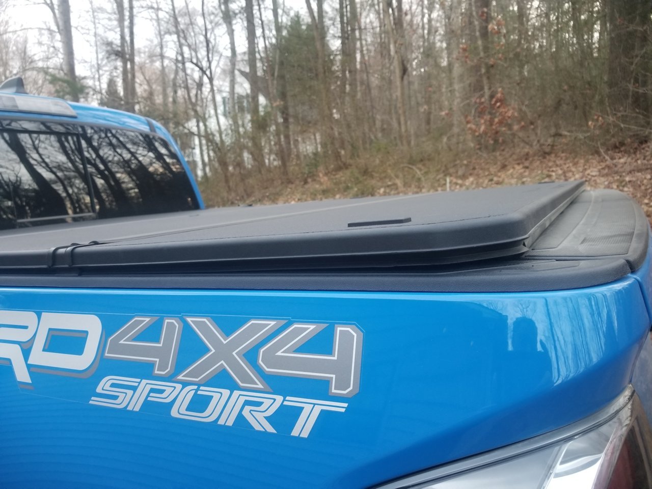

    The Tonneau Cover that came with my truck has a gap in thee rear that allows water to get into the bed (see pic). Worse of all, it allows someone to lift the back flap enough to look into what is under the cover. Is there a way to adjust this? Is anyone else experiencing this same issue?

    As best as I can tell. I tried pushing each corner down without results. The worse part is it lets rain or snow in while driving in such weather.

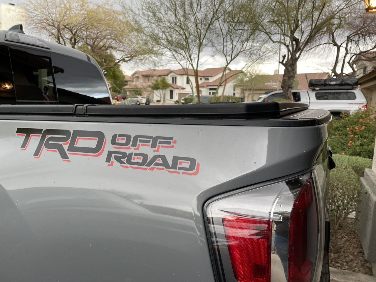

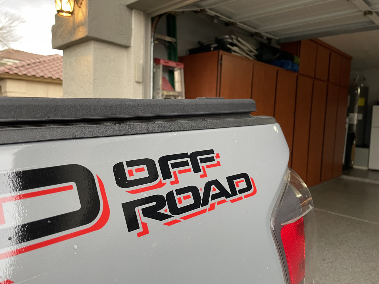

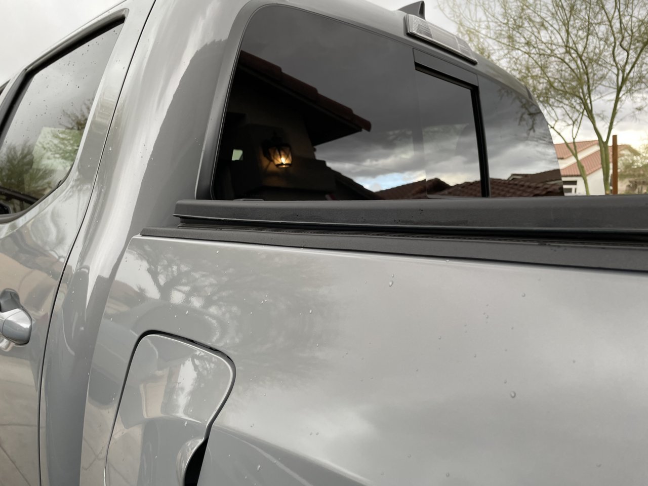

    Here’s mine. 80943686-E038-4168-A262-DBE250E54D8E.jpg82A7BAF8-9AD7-4F6E-9D12-52757C2A172B.jpgCF21C5A5-FE53-4C7B-ADB0-2A103E42DAF1.jpg
