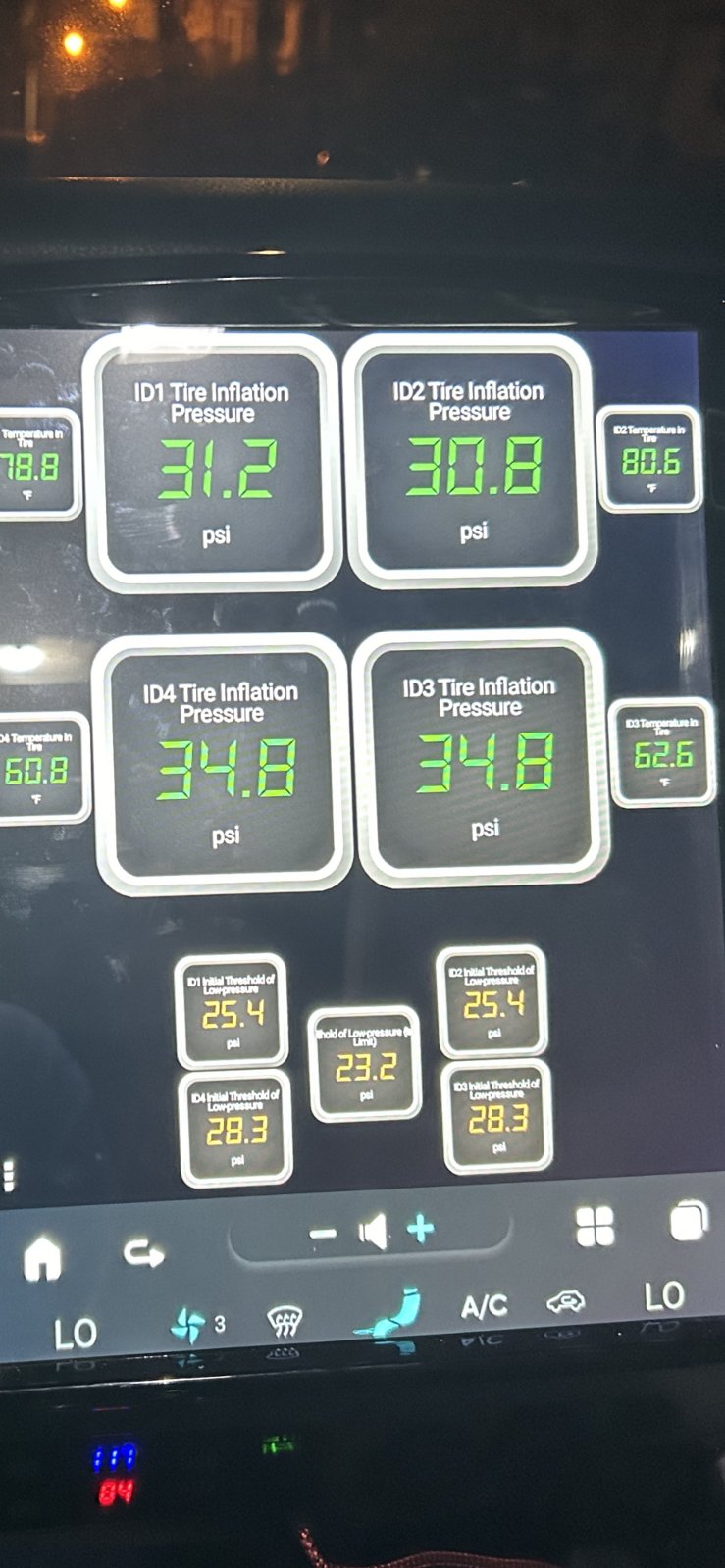

  20. Nov 27, 2023 at 11:24 AM
    #20
    Draden
    Draden P911RSR
    Mar 14, 2015
    #150837
    101
    Socal
    2015 Tacoma DCSB "Off Road" 4.0L
    Let me help. See this picture of my 2015 Tacoma android head tablet displaying a customized page i made for TPMS data.... this is programmed to display data being processed in my TPMS brain box using a virtual serial port connection to it and KWP2000 protocol (you cant see this data with a regular odb2 reader connected to the trucks ecu. You have to log in specifically to the tpms module (not the ecu) to see this ..... Regardless......
    What you are seeing at the bottom of this page is the 5 stored settings that were calculated when the TPMS set button was last pushed (i did not just push it, bu t instead it was pushed and calculated the 5 yellow values a few months back when i last pumped up all my tires. Note that I run my front tires on 31.5 and rear at 34.5 based on the weight increase mods I added and performed a chalk test drive
    also note that the tire pressures will change as the tires and air temp warm and cools but I like i said, I did press the set button a while back when the fronts were both reading 31.5 and the rears reading 34.5.
    if you look at the yellow "initial" threshold value for the fronts. They were calculated to be 80 percent of what the measured value was in each wheel at the moment you pressed the set button . once set, they stay that value indefinitely unless you press the set button again.
    This is the “initial threshold”. Meaning that’s the values in each corner where each individual tire has to have a pressure drops to at or below its initial low threshold then the TPMS light will FLASH. The 5th value that is in the middle is the Low pressure threshold. As opposed to the “initial” low pressure thresholds for each corner. This value gets calculated to be 75 percent of the lowest tire pressure seen from all 4 sensors at the moment you press the button
    so if you get a TPMS light flashing or solid and you just press the TPMS SET button thinking is some reset, all you did was mess up your values and you likely will still have a light on because one of your sensors is bad youll want to replace that sensor, re inflate all your tires to proper levels then press and set your TPMS set button again to have the system calculate and have values that are meaningful
    im sure that very few people on here know what their TPMS threshold values are set at on their truck and very few ever care (fair enough) but when you get a idiot light, at least you can now understand a flashing vs a solid and how the system is intended to work and what the system is trying to tell you, and help you to understand what to do about it
