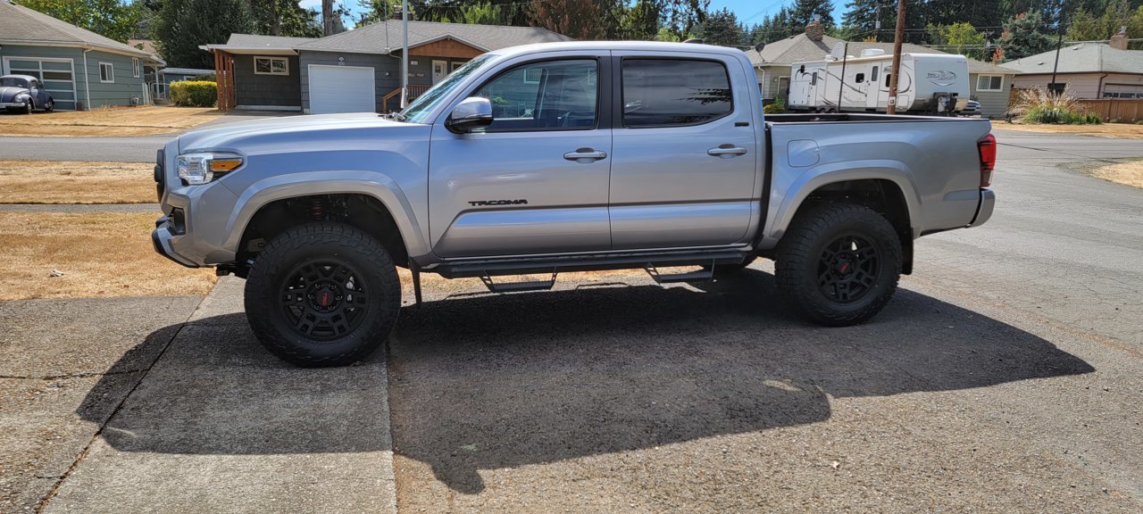

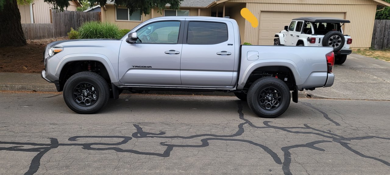

    When I got mine installed, it cost me $2200 OTD. I also got to keep my fogs because I asked him to, which initially he argued with me but ultimately gave in and left them alone.
    Here is a before and after pic of my Tacoma. One is TRD lift kit on stock wheels/tires, and other is with TRD lift kit on TRD Pro Sema wheels wrapped in 275/70/17 Falken WP AT3W's
