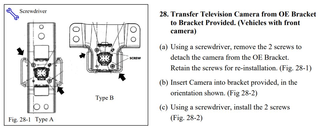

    I just got off the phone with my local dealership, and will be picking up this kit on Saturday. I will ask a few questions about the sensors and if any calibration is needed. From what he and I discussed, it all seems pretty simple once you start to swap out the grill. Should be plug-n-play for the most part.

    The front camera works fine. The non-pro camera is transferred to the pro grille and uses the adapter bracket provided in the kit.

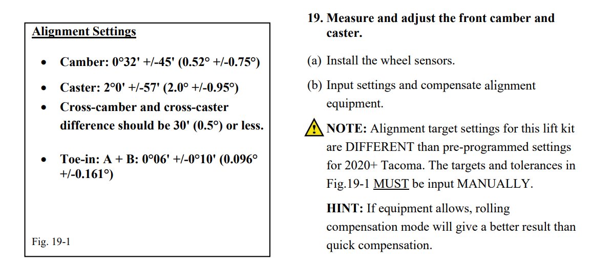

    Alignment yes, the install guide has manual corrections as well, see below. You also need the TSS radar sensor and forward (windshield) camera calibrated. Though the front terrain camera will be moved higher, the install guide lacks the calibration process, probably because it is quite complicated and expensive at dealer rates. You can adjust the alignments of all the cameras in the special service menu of the head unit.

    What I was thinking about. I can also ask a few questions when I pick it up. I'm good with doing all the mechanical install/calibration. I might have to get them to calibrate all the sensors. That might be over my head, but will wait to see what it looks like when I get it all apart and back together.
