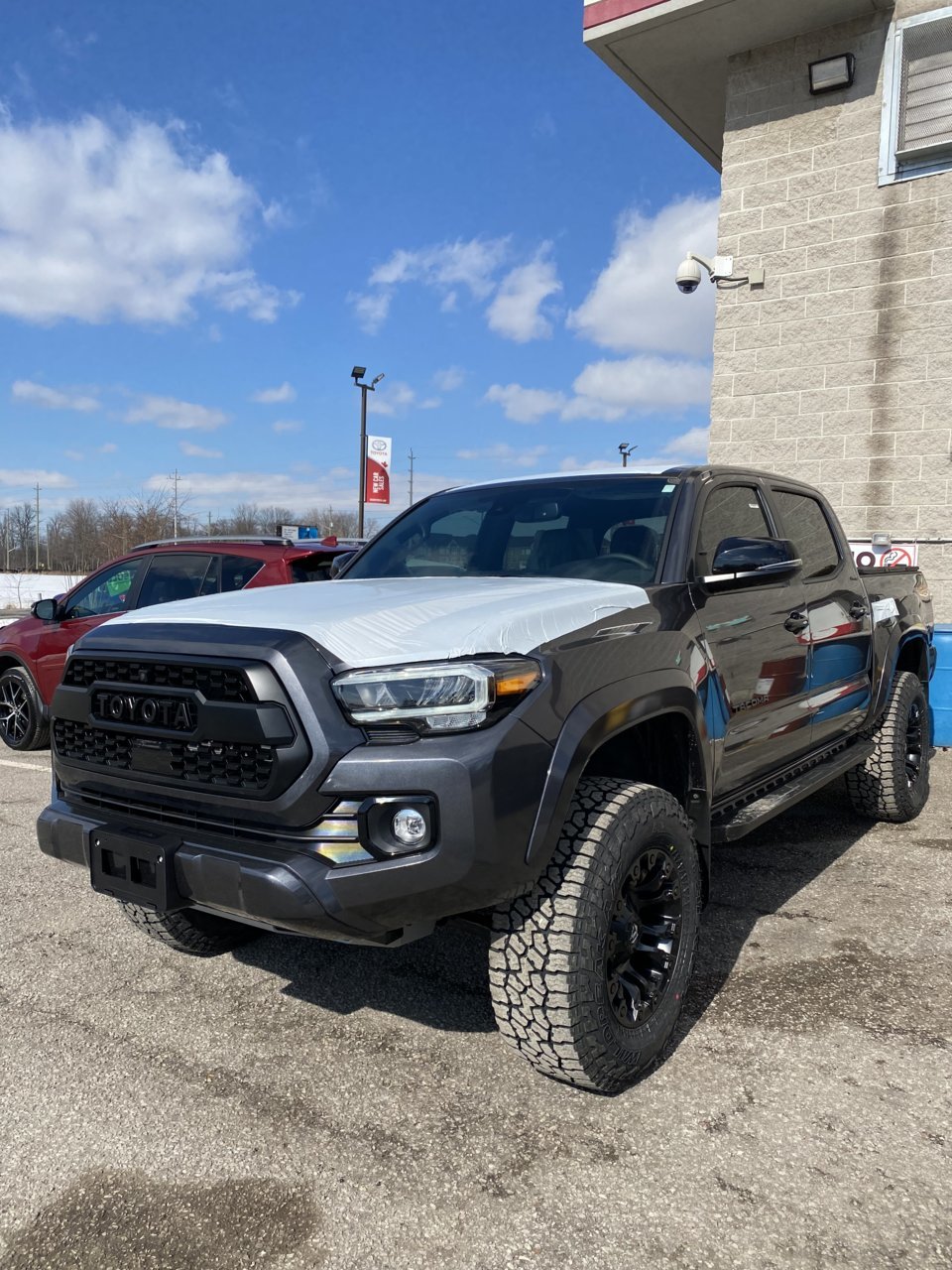

    42EC048C-4F8B-4D9E-B84D-41F5D1041FF9.jpg 12A30209-8678-449E-B683-FDDCFF32EA28.jpg
    All installed no rub so far! Learning quickly that the ko2’s are no better than the stock tires in the snow but that’s all good I’ll keep it sideways until the weather gets nicer.

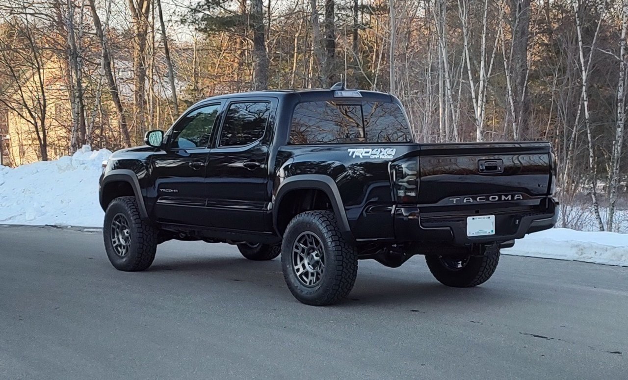

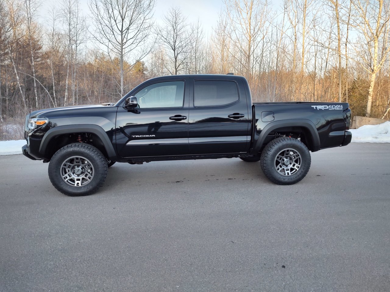

    I realized I haven't posted pics of my lift, so here's a few:

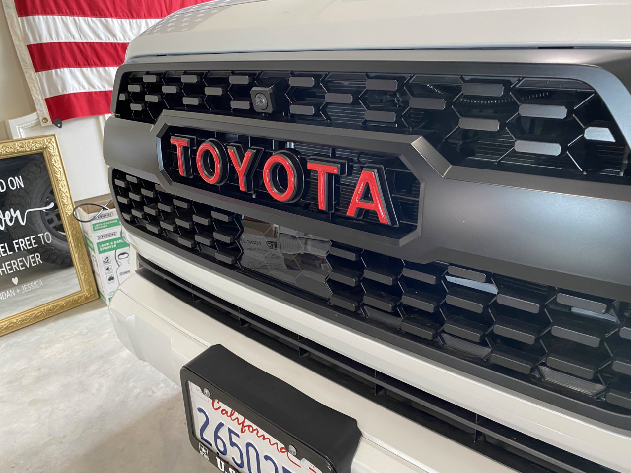

    I think the pro grille that comes with the OEM lift adds a nice touch!

    Truck look nice! Did Toyota leave the off-road grill in for you? They never gave me that option

    I asked if they could leave it, and the fogs, and they had no problem with it. They just installed some washers on the top of the TSS sensor to tilt it down a bit.

    Good to know!! I asked them if I could change to my original grill down the road was told no makes me happy knowing I can.

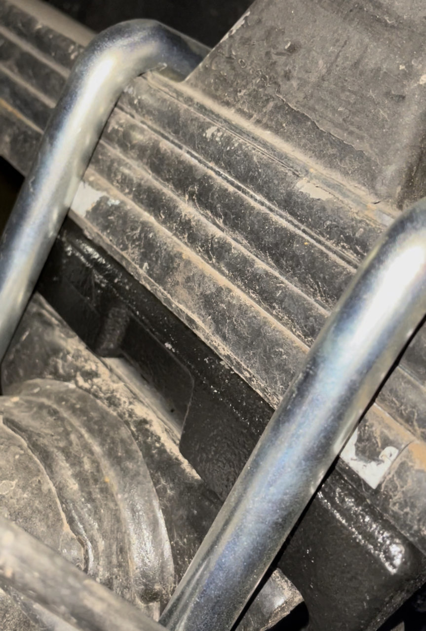

    Check your axle pack for a taper shim in the assembly.
    Mine had one from the factory. Maybe they left it out after putting the block in the leaf pack.
    You can purchase a 1" block with a taper built into it which usually solves the vibration. I used one along with the factory taper shim in my build.

    Thanks man, I will check this out as soon as I can. I don't really know what I'm looking for but have seen people putting those shims between the axle and bottom leaf, is this what you mean by the axle pack? I will probably have to wait until Thursday since that's my day off. Hopefully this is something dumb and minor.
    The vibration is noticeable but it isn't jarring, pretty mild. Feels kind of like 1/1000 of a death wobble or something I guess.

    Thank you so much man. I see exactly what you're talking about. It looks like they left it out? Here’s a pic.
