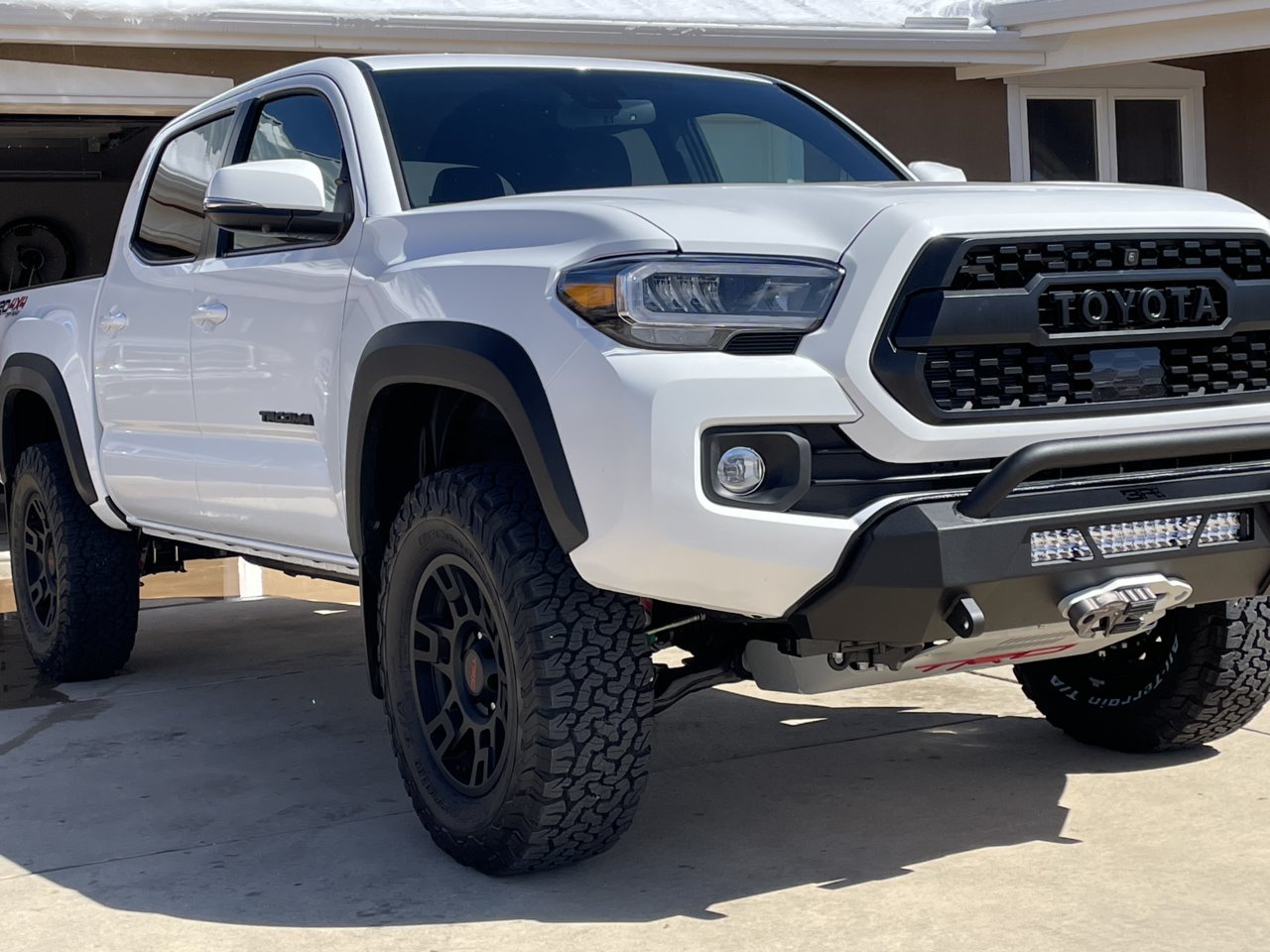

    TRD OEM Lift, TRD Skid Plate, TRD SEMA wheels and 265/70-R17, Body Armor Hi Line Bumper, Smittybilt X2O Gen2 Wireless Winch, ProComp 20" light bar, Factor 55 Ultrahook; Currently looking for sliders
    E6D98F57-345E-448E-AA58-5F0D0E9D4561.jpg 2022 DCSB OR w/ TRD lift, TRD wheels and BFG AT 265/70-17. Just installed Body Armor Offroad bumper, Warn 10K wireless winch, 20” ProComp light bar and Factor 55 Ultrahook I won at a raffle.

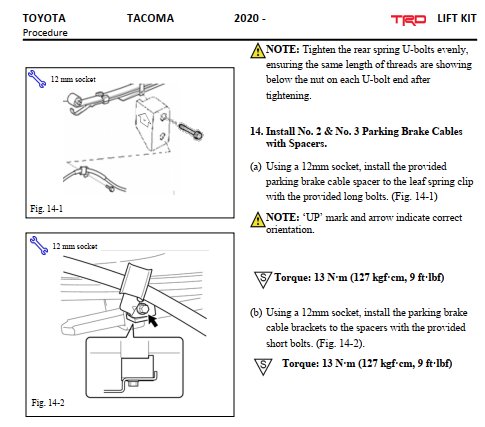

    Finally installed just the suspension components. Here is a list of the parts for anyone interested.
    (2) Taco Suskit Shock Front
    PTR13-35210-FR
    (2) Taco Suskit Shock Rear
    PTR13-35210-RR
    (2) Nut Lock
    90177-A0012 (Rear Struts Come with them)
    (2) RR Leaf Spring Spacer
    PT82A-35210
    (4) U-Bolts
    90117-14011
    (2) Taco Suskt Spc Prk B
    PT595-35220
    (2)Toyota Bolt Flange W Washer
    91671-80840
  10. Mar 28, 2022 at 8:44 AM

    @mrlobaloba
    May I ask, Is this 91671-80840 a brake line bracket? what does it bolt to? different than stock? thanks...
  16. Mar 29, 2022 at 7:52 AM
    #2496
    mrlobaloba
    mrlobaloba Well-Known Member
    Oct 16, 2020
    #343964
    61
    Brian
    2020 TRD Off Road
    91671-80840 is the longer bolt and PT595-35220 is the actual bracket. It lowers the brake line attachment.

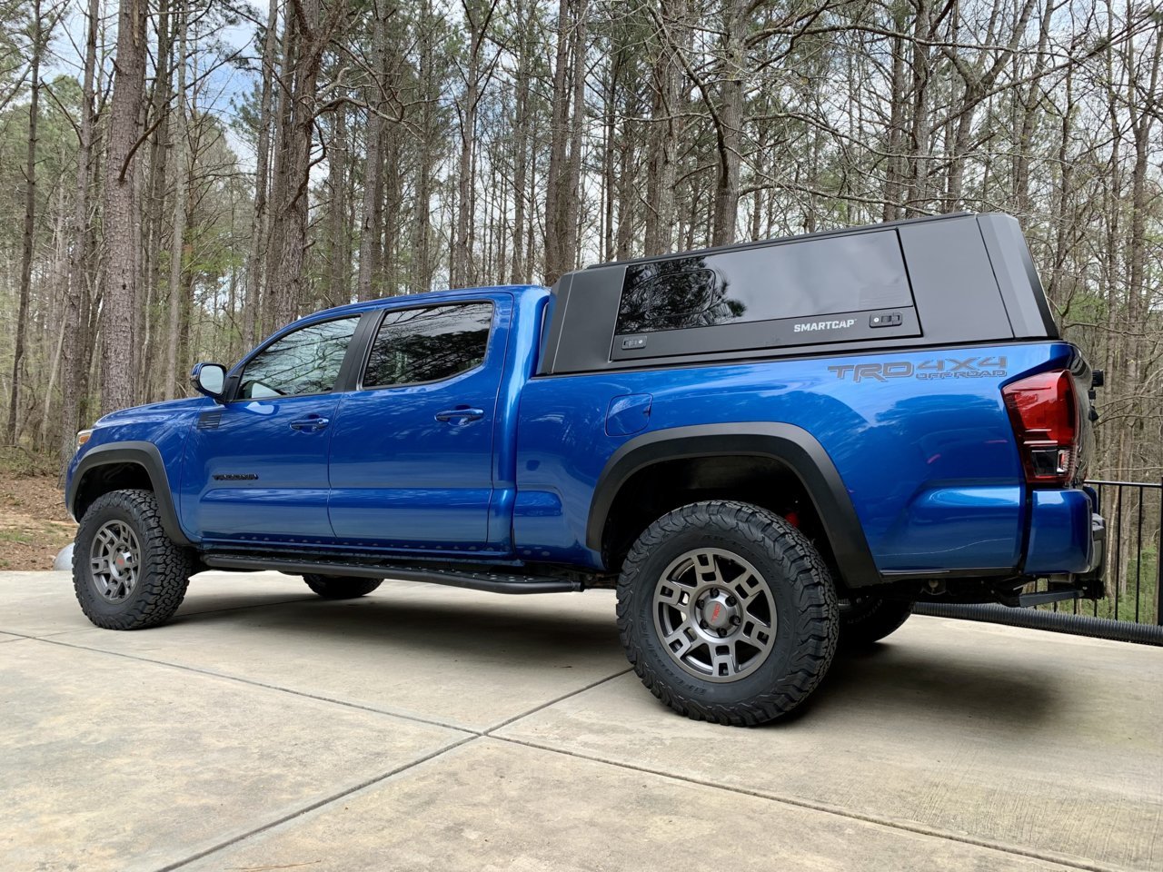

    3
    Allan
    2018 Tacoma TRD Off-Road 4x4
    Stock
    2018 DCLB TRD OR. 265/70 17 K02's. Went with the TRD lift kit based on the posts in this thread. I read every. single. one. :) Also did the ECGS bushing and rear driveshaft spacer as a preventive measure. Installed myself. Had no problem getting the kit through a dealer here in Georgia.
    Lift is just enough. Rides as good if not better than stock. Will probably still do new rear springs soon due to the weight of the shell and my daily gear carried in back.
