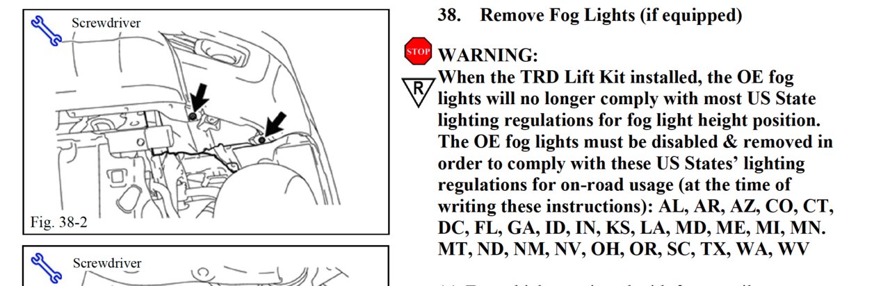

    Why is there foglight block off plates? Do they really expect Off-Road/Sport owners to remove their foglamps and install block off plates? Tyota thinks the foglights will now blind other drivers with the additional 2" in height?

    It's a legal issue. In some states, the auxiliary lighting or fog light must be under a certain heigh. With the lift, it raises the fog lights above the max. Toyota puts them in the kit so they are there if needed for the state. I have read in this thread some dealers place them over the light so you can remove them at home easily.
    EDIT:
    Page 26 of the installation instructions:

    Ya I had to request that they leave them in and one tech fought me on it. Then a second tech came up and was like "don't worry bro I got you"

    I ordered my truck with the LED headlights and fogs lights and the dealer left the fog light in when they installed the TRD lift. No questions asked and no issues.

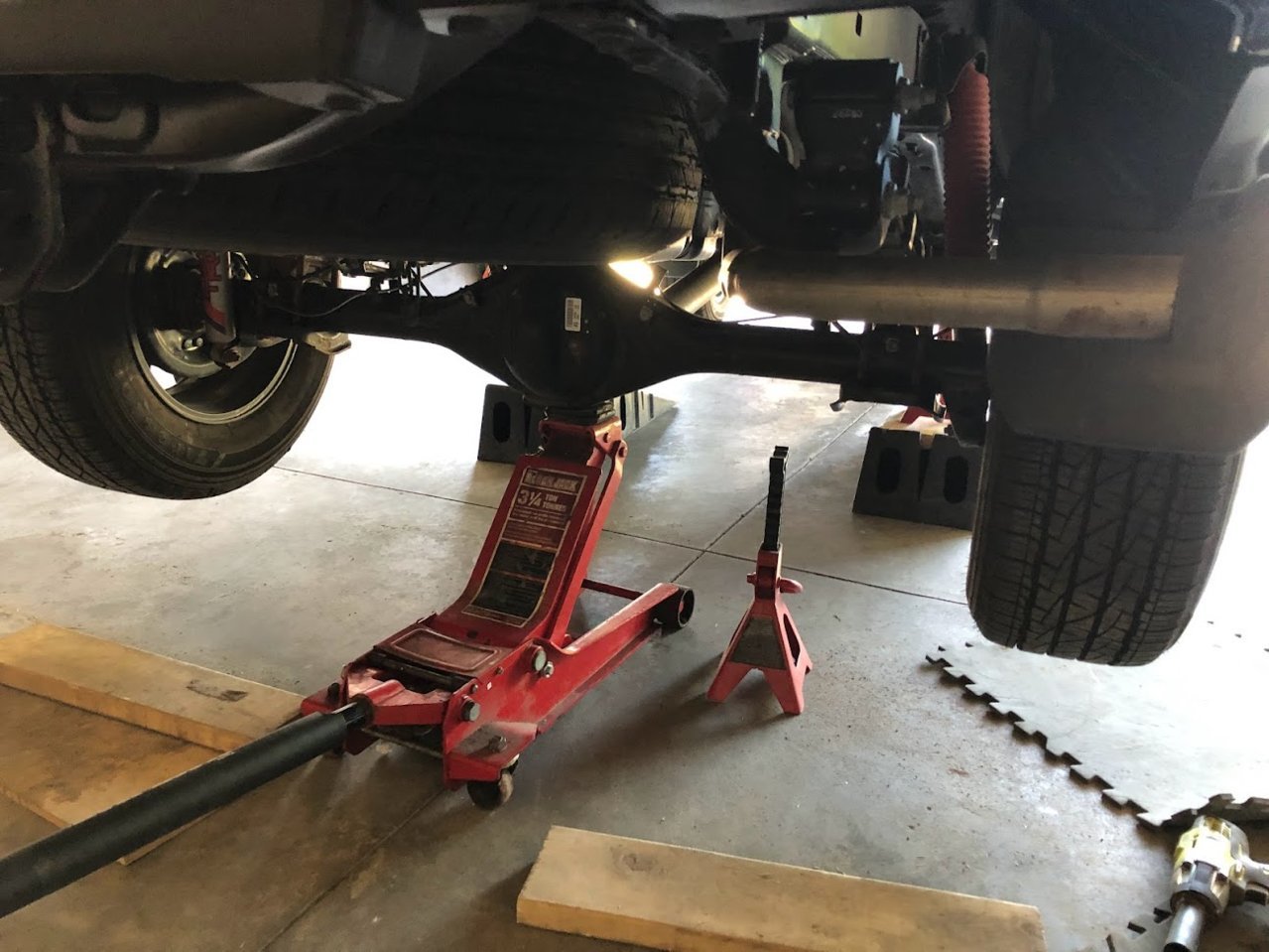

    So I ended up installing the belltech shims today and looking at the size I feel like they should be longer and less wide for better fitment. Either way after installing I'm not really sure I felt any difference. Maybe the rumble strip effect is gone, but I still get a bit of vibration at 50mph and higher speed braking. I guess its just the nature of the vehicle. Surprised how quickly I was able to do the install with only 1 jack also.cKfwaiAMADZU4Bj1JF6rERQuGZVM_OxaWwjwhKIN_ff787d6a8400b3f3a6a320ab96ceda674b21f831.jpg

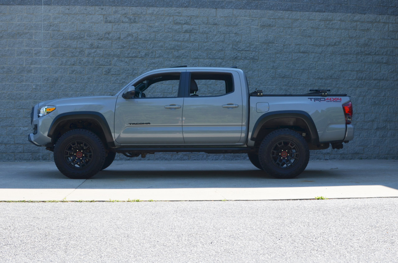

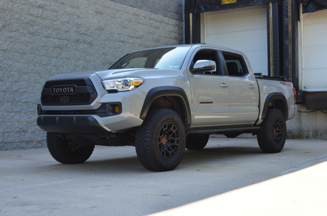

    Did the install this weekend. Set the fronts at the middle notch and added a 1 in rear block from Low Range Offroad.

    Size tires?

    265/70/17

    Looks great. So would the front be a 1.1” lift then?

    265's looks perfect with 1 1/2" lift upfront
